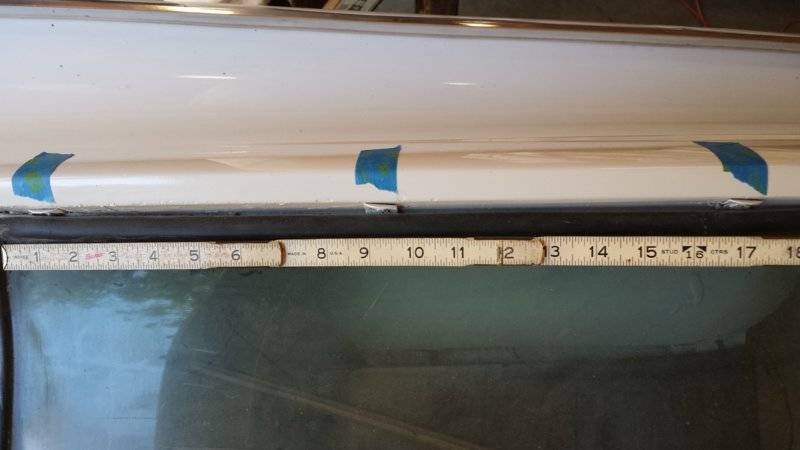

It's a tight fit. I took measurements for future reference to find them if necessary.
https://www.forbbodiesonly.com/moparforum/threads/rear-window-trim-clips-and-placement.162250/
