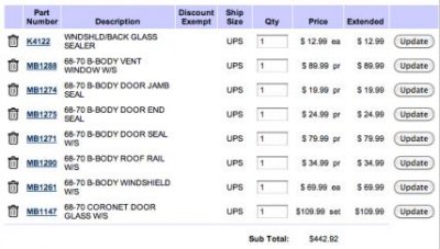

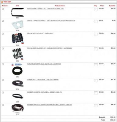

I think I have managed to cut it down to 3 vendors, one is local. Here is my lists, if you see something I've missed, got wrong or being majorly ripped off please let me know!
Also sorry for pestering you all with this but hopefully this might help someone else looking to do the same thing in the future :grin:
From Detroit Muscle Technologies:
Firewall AC gasket set BXX6670FW01 - $35
Paint Gasket Set BCO6868PK01 - $65
Splash shield Auto set BCO6869SS90 - $88
Classic Industries:
See First Pic attached
Pentastar Parts and Restorations (Australian):
See Second Pic attached
I think I might be missing the inside glass fuzzies? Also, firewall insulation, I was thinking I'd go the dynomat route, would that be a suitable replacement for the insulation? Or will I need that as well?

Looks like you've got it all, I believe the windshield wiper linkage seal kit is included in DMT's firewall kit. The dynamat could take the place of the insulation but to be honest I used both. I didn'tuse dynamat though I used fatmat which is the same thing but cheaper.
On the window fuzzies what you are after is part number MB1147 from Classic industries. Keep in mind that Classic Industries usually always has a 20% off coupon floating around. Whether or not there is a current one I don't know.
Some of the things you have ordered from the CI and the AU company can be ordered through DMT as well but the prices may be the same.

With the fuzzies, are they not part of MB1147? So I will need fuzzies and the 8 pieces window rubbers? This is why I'm getting confused.

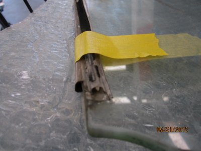

There is one other one that you don't have that you won't see until you remove it from down inside the doors. It's this molded u-shaped window guide. I can't remember what it's called and I honestly can't remember where I got it a few months back. Not many places carry them. Jeff from 521 restorations on here told me where to get them, so I'll dig back in my email and see if I can find it. Here's a photo.
Found it! Here's the info with part #'s I had gotten from Jeff.
"Yeah, that's the channel. Looks like they sell them with the clips too.
Looks like Year one has them up as part number FD32230 for $73/ea.
Legendary is at $79 as part number WS66C-BVENT. You could try calling
rtspecialties.net. He's listing them (out of stock) also.
I ordered mine from Year One. You can go to either website to see the profile drawing.
