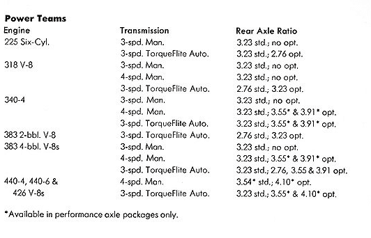

From the 1970 sales brochure:
An actual GTX only had the 440, 440-6 & Hemi as engines and had the performance axle package 8 3/4- 3.55 or 4.10 Dana 3.54 or 4.10. IIRC 4 spd's all had Dana's either 3.54 or 4.10. 727's could have either 8 3/4 or Dana & either gear ratio.

In the list it doesn't state anything about Dana's, maybe they were available for both but not mentioned for manual as well as automatic?

The sales brochure in #6 is for ALL Plymouth models. No slant 6's in GTX's. Road Runners standard was 383 "Magnum", optional were 440-4, 440-6 & 426 Hemi. Standard for GTX's was a 440-4, 440-6 & optional 426 Hemi. Dana's were certainly available behind 727's as well as 4 spd's in 1970. Track Pak axle package had the 3.54, Super Track Pak had 4.10.
