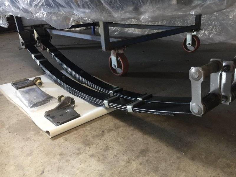

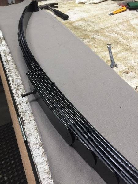

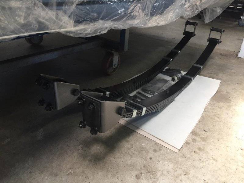

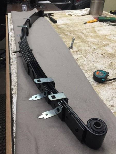

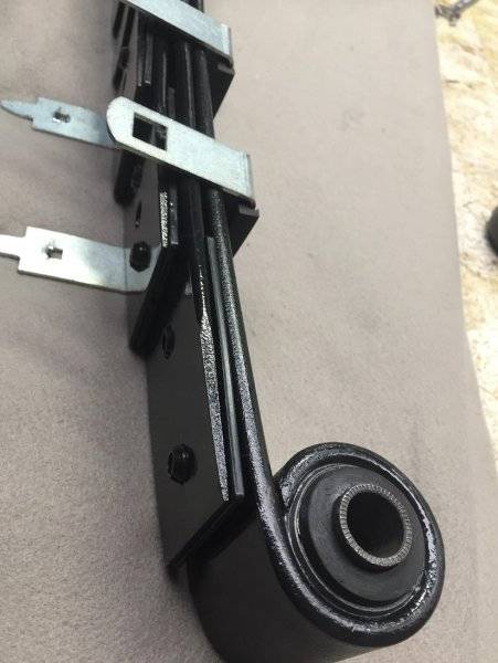

Done a full restoration on the rear leaf springs recently i pulled them apart cleaned ,primed & painted them. Brand new bushes front and rear new plastic pads and galvanized plates, new bands ,new eye bolts & new u bolts should be a nice tight ride now I'm pretty happy with the outcome for a first timer.

If you're referring to the silver bands, they can only go where there's holes in the leaf.

Purchased the rebuild kit from mega parts shackles and plates are my originals they were in good nic just cleaned and painted with new bushes front and rear

Thank you sir but i can't take the credit as said the springs have location holes you really can't go wrong but you need to keep the bands tight both up and down and from side to side while clamping them around the leafs that was the hardest part
Never had a set of leafs that had location holes for the clamps. In my early years as a drag racer, I tried numerous numbers of clamps and spring clamp locations to modify the way the spring reacted. Sometimes it had noticeable effects.

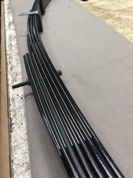

you can just see in the first picture were the band is sitting there is a hole for the clamp locator to sit into
Again, never had a set like that and I have had many sets of OEM springs. Just saying.

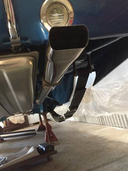

And they are back in place just waiting on the 8 3/4 to be finished
