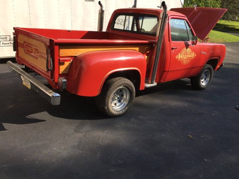

Pics of your LRE?

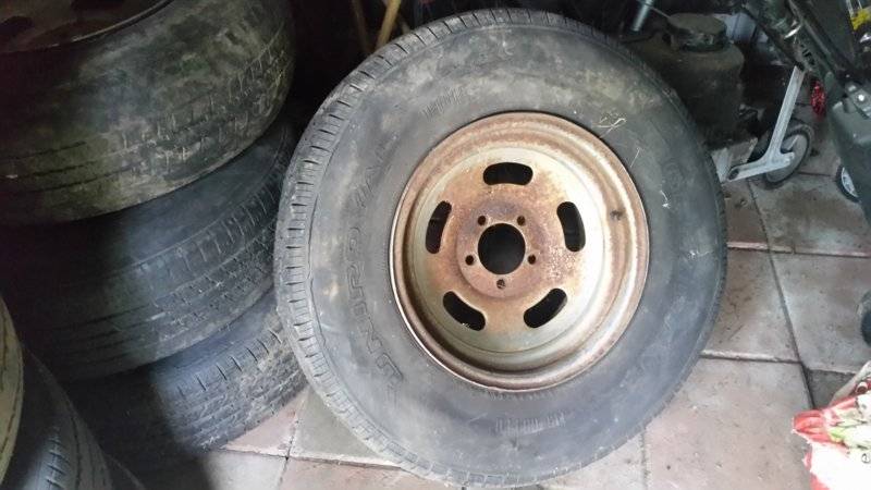

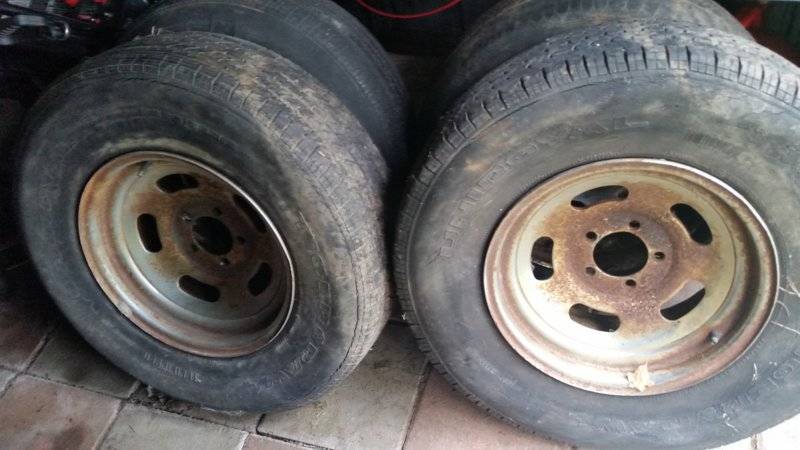

I have an old set of these LRE/Ramcharger wheels also that will need re-chroming someday.
Many of the chrome shops will not do wheels as they fear that the process will weaken the wheel structure and thus they become a liability.
khryslerkid those wheels are very close. Not sure where to get a price? I currently have 8 wheels, but they need to be rechromed. They are all 8" wide. The 78LRE had 7" on the front and 8" on the back. Trying to stay as close to original as possible. I might have to sell some of my B body parts to pay for the wheels!!
