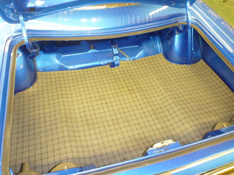

Here in Illinois the moisture under the trunk mat was solved by always leaving the deck lid of the Plymouth open while parked in the garage, California car cover installed. I used to have to remove all items and the mat to keep that sneaky condensation from forming. I have both types of mats and at lease this tip keeps em dry.
I learned decades ago to roll the mat up and take it out until you're ready to leave for a car show. Bird is pretty crusty under the OE mat. That said I have my shop cranked down to 30% humidity, so not worrying about it too much these days with fresh paint on the Bee.

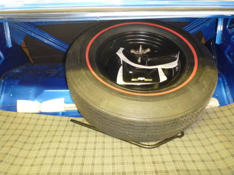

Slightly off topic, but referring to the photo above... is that the correct installation of the spare wheel & jack parts (wheel > round flange > jack base, bottom up > jack hook > wing nut)?
I ask, because I’m missing the instruction sticker(s) that I think was on the underside of the trunk lid, back in the day. Are those stickers available as reproductions?
Yes they are. Look on Classic Industries or Year One websites
