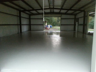

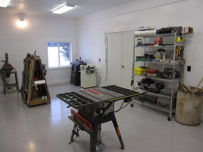

I used extra coats of clear concrete sealer on my shop floor although certain chemicals do dissolve it on contact but it always hardens back up. I use a cutting torch so I wanted a tough surface that would stand up to molten steel. Now I do have epoxy in my wood shop (light gray) and it cleans up well except it is prone to rubber streaks from shoe soles but, they wash off. I have been using my main shop for 18 years now and it still looks good. I do use oil dry compound whenever it's needed.

We used a commercial grade epoxy on our 40x60. It has worn very well, the only solvent/ chemical that has affected it was brake fluid.it doesnt lift it but makes it soft until its cleaned up.
It was easy to put down, the hardest thing was getting the new concrete cleaned with muratic acid.
