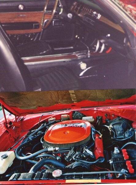

I just use an old quart of oil container. Wedges perfectly between firewall and battery. It's been there probably over 25 years with no issues. Helps so no puking all over the ground in our hot Woodward cruise traffic every year. Hard to see but the over flow hose is going thru the cap here.

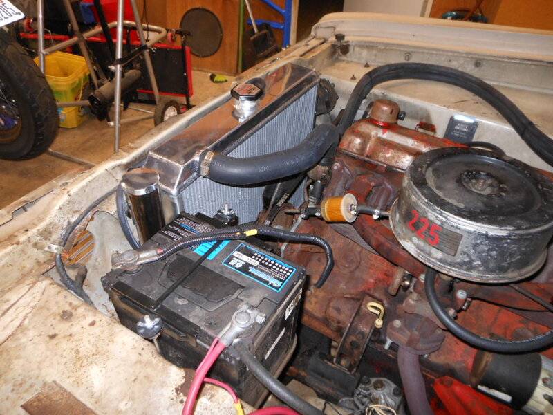

I found this one at Champion Radiators. It's pretty compact and comes in a variety of lengths. It was reasonably priced, too.

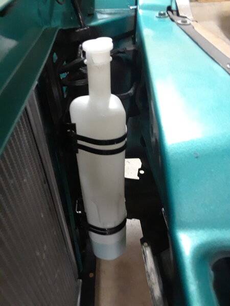

The bottle I got was a 48 oz, smoked gray plastic one that almost looks like it could have come from the factory.
It even has graduation lines.

On my car that bottle fits reasonably securely behind the headlight bucket on the driver's side.
There is a ledge there and it's almost trapped. I haven't had to put any strap or bracket there and it's never tipped or spilled.
