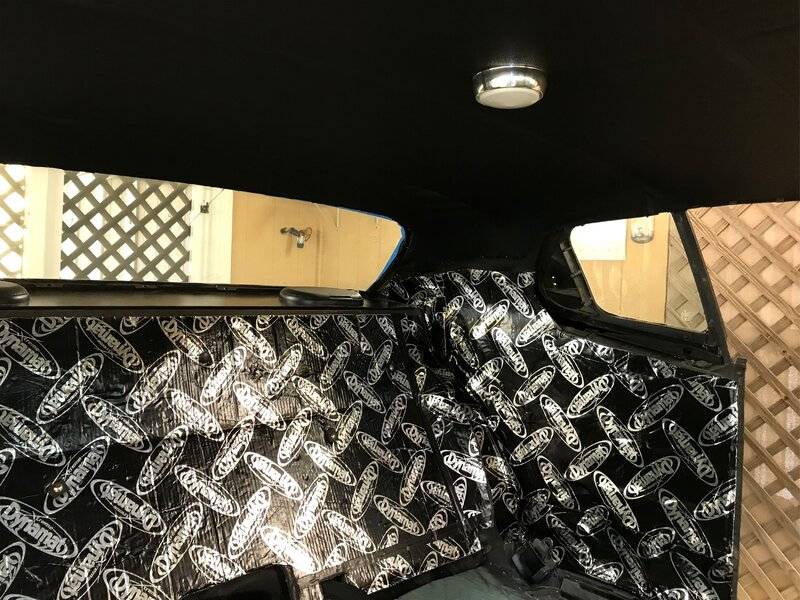

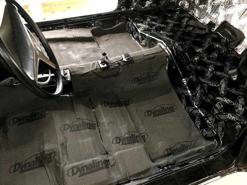

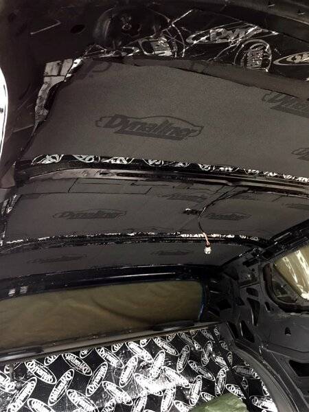

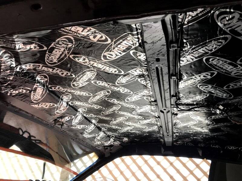

I may have gone a little overboard with the Dynamat products; attempting to keep out as much west Texas baking summer sun and some of the Charger's new performance exhaust noise. In addition to covering all the areas you mention the underside of the roof and the floor got a layer of Dynamat then a layer of Dynaliner. The passenger compartment to trunk divider got Dynamat and DynaPad. Dynamat products conform to contours very easily. I found the roller is excellent for doing this.
Getting the floor done before installing the dash is a good idea but with the seats out it's not necessary. Plenty of room to roll around in there. Even for fat old men like me.. Here are a few photos..
