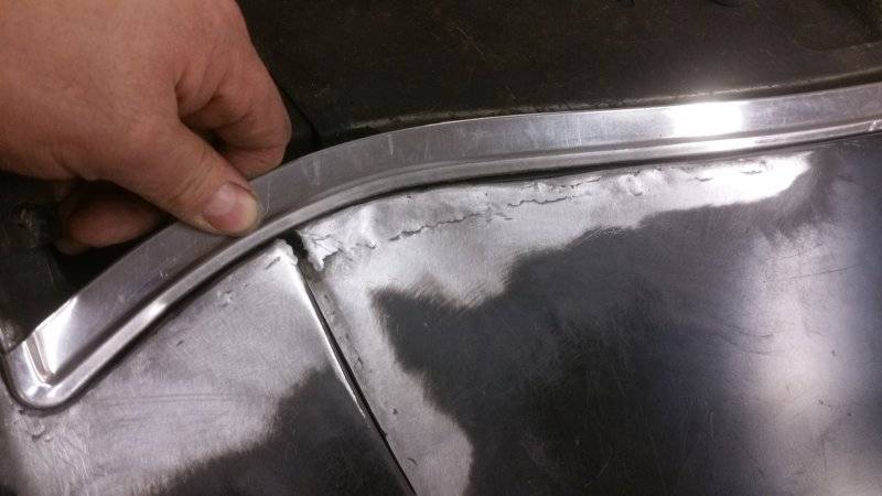

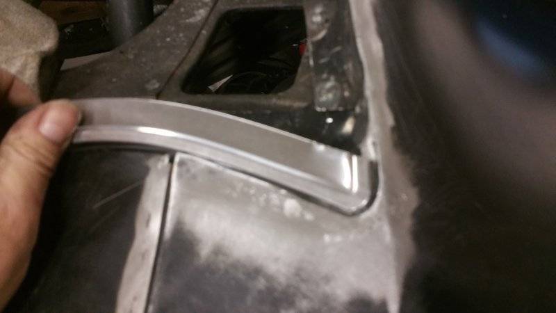

Has anyone ever tried reforming rear window trim on GTX/RR rear window trim? I found out after the fact the AMD Dutchman panel isn't even close. I've got a 1/2" gap on the first radius from the corner. Not sure if I can heat it, or cut and tig it? Thanks for the help.

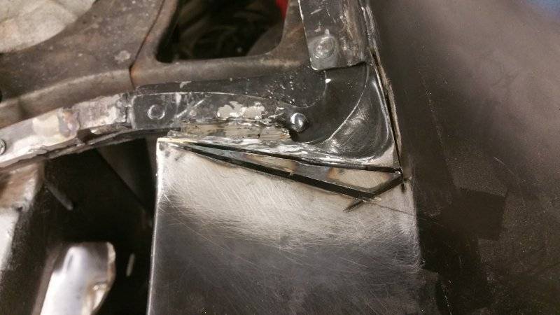

Thankfully when we did my 68 RR, my brother is a very good body man and we cut and welded the dutchman and had the stainless trim on the car to fit panels to that. Actually had to weld up those areas to fit the trim, and of course fit the glass also as we went.

so the radius
The tight radius on middle pieces

As I said earlier. we had to section the AMD dutchman panel. It was no where near correct. ruffcut

The trim is not easily formed to different shapes, and you don't want anything painted until everything is fit and
cut up/welded back together where it needs to be.

Waaaay cheaper at this point to modify the trim. Cut and tig it or mig with stainless wire.
