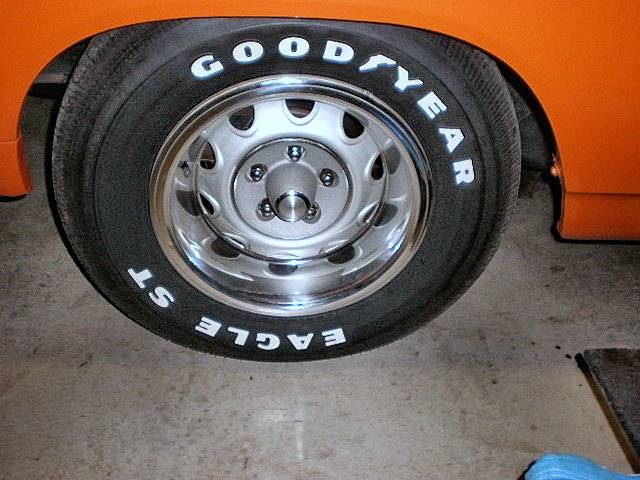

What you can do if you take your time,this was at one time brushed stainless,each one took about an hour.
As stated, get the dings out and sand up to 3k! When polishing trim, ALWAYS tape a piece of wood to the trim, this allows you keep better control of the trim and it’s not so hot on your fingers.
