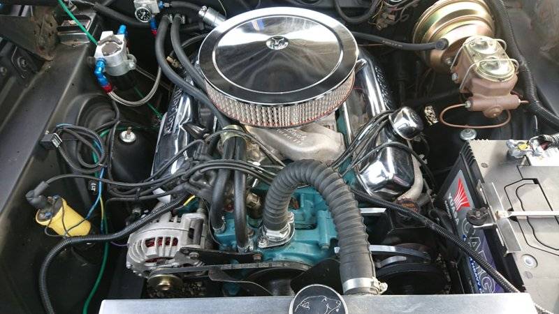

Hi Steve,
Don't know if it's of any help, but here's the install on the 383 on my '68 Satellite - Coil is the yelloe Edelbrock unit lower left.

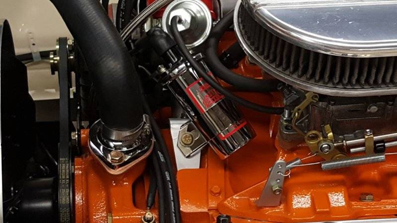

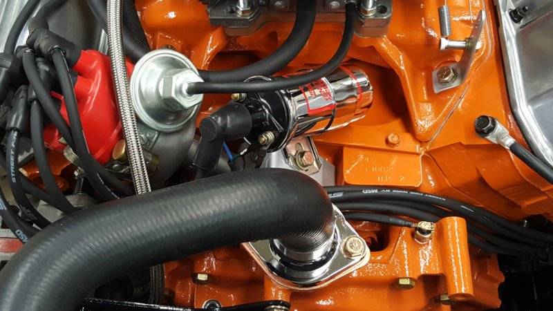

Six pack coil bracket mounts to intake bolts, doesn't it as an option.
Here's one option. I didn't have a good spot on this manifold and I saw where someone else did it. I believe it's a GM clamp, just one tab for the bolt. Drilled and tapped a hole in the dizzys hold down clamp.

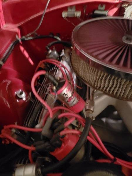

I mounted mine up under the windshield washer reservoir on the inner fender. Lines right up with the dizzy,
extended the wires over to it no fuss. I wanted to keep it off the engine and the heat soak that brings.
Cleans things up under the hood a bit, too.

Yes, that was/is a very popular spot on BB Mopar. Off the engine heat & near the dizzy.
