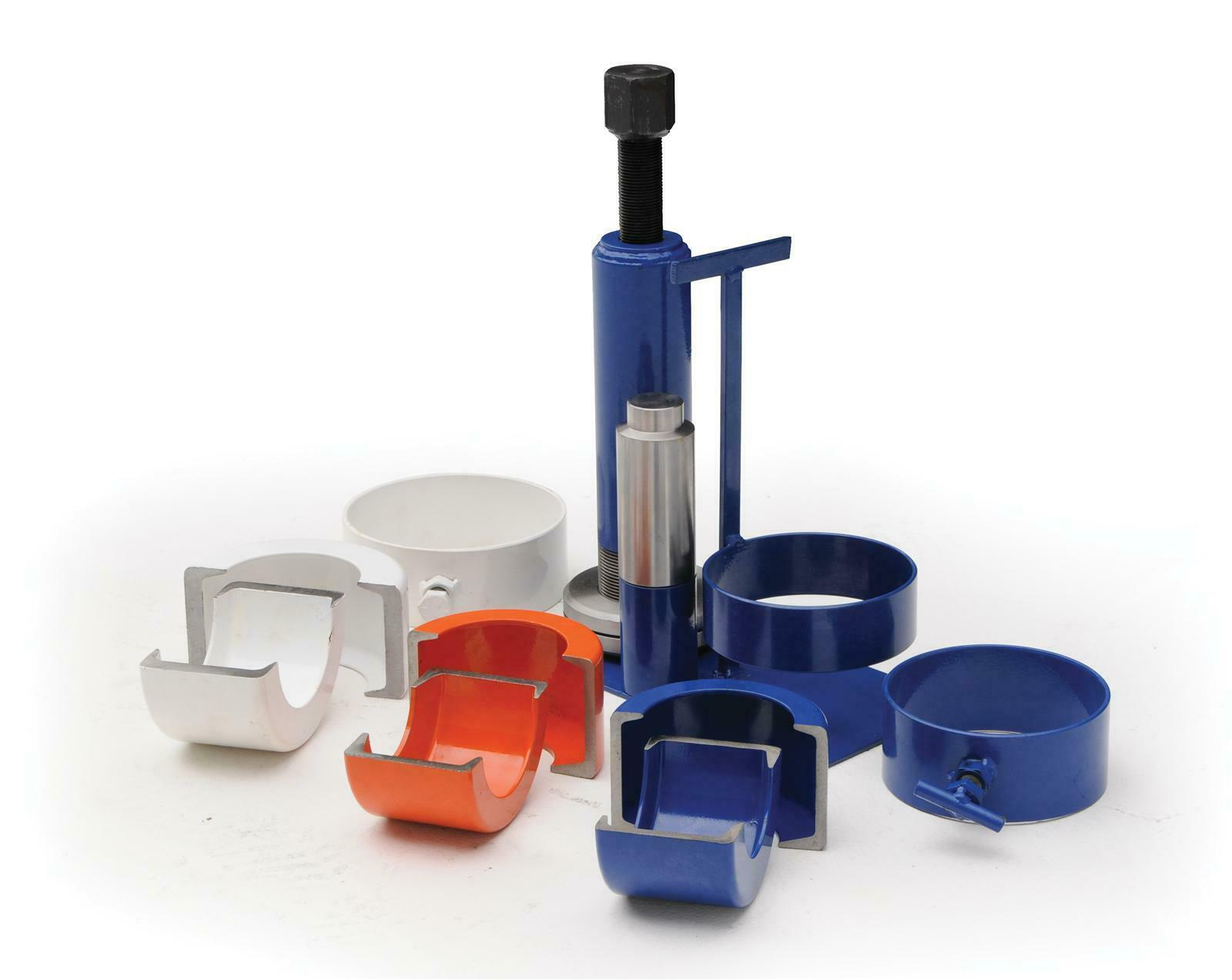

Doctor Diff offers a tool that will pull the rear pinion bearing without damaging it.
