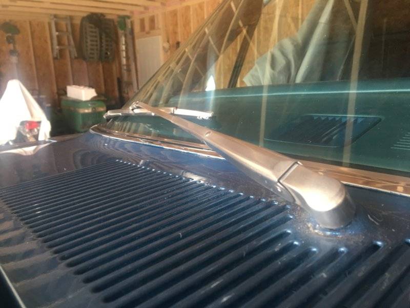

What’s the trick to removing complete wiper arms ? There’s no clips to pull out like some arms have.

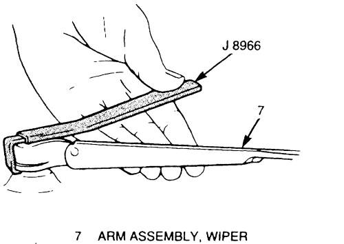

You will need a tool. Search eBay for 65750 lisle.
Lift the arm all the way up, pull the lever over (which locks the arm up), and wiggle it off.

Thanks for the information and the picture. I skinned the paint on freshly restored car trying to get the wiper off with the wrong tool.

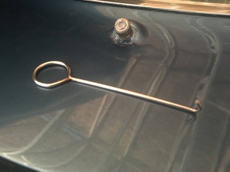

Wanted to revisit this thread and help anyone in the future that comes across it. Im extremely cheap when it comes to buying a tool I ll only use once or twice in a lifetime. This works very well, a spring puller. Lightly pull up under one side while pulling up on the arm simultaneously. A paint lid remover works too.

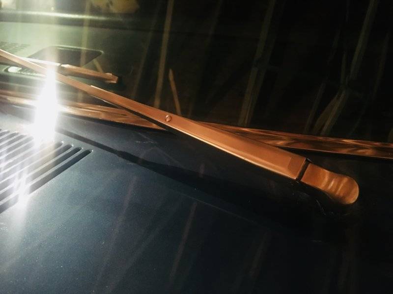

Lookin perdy. These were oxidized pretty well. Took about 20-30 minutes. Worth the effort, they make the windshield trim look that much better too.

Always lay a blanket across the entire hood. I have the chip from hell on the power bulge made by the arm as it rocketed by. Over polished too, now there is glare.
