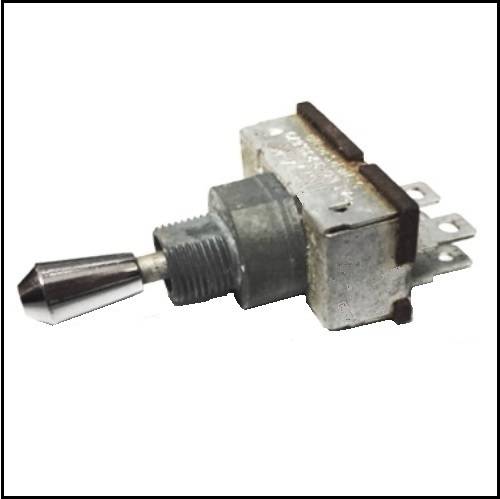

Can someone tell me how to remove the knob off this emergency flasher switch? The switch is out of a Coronet. I am including a photo of the switch. I am swapping knobs with the original one I have out of my Belvedere. Thank you.

I believe they just thread on to the shaft coming out of the switch. Might need a small pair of needle nose pliers to hold the shaft while trying to free up the knob.
I just pulled the knob off my 65 Belvedere HL switch and it was pressed on with a sort of coarse knurl on the edges of the triangular shaped shaft. Another possibility.

I'm afraid it wasn't meant to come off because it was made that way. Oh well, thanks for your responses.

Is there a possibility of taking the switch housings apart and swapping the parts?
Appreciate your replies. Guess I didn't make it very clear. Switch is out of the car, but the knob itself (see picture) is what has to come off. I believe that it can't because it wasn't meant to. Coronet and Belvedere knobs are different and apparently not interchangeable.
If you have a junk switch cut it off with a grinder (cut-off wheel) and perform a diagnoses on it's construction.

I bet it's screwed on and has thread locker.
(not today's thin type but a sort of pipe thread yellow-ish type)

No, I wasn't able to. Took it over to a neighbor who was a former GM tech. Said it's not possible to be removed. I'm sending it back to the guy who sold it to me. Back on the lookout for a used '67 Belvedere emergency flasher switch.
