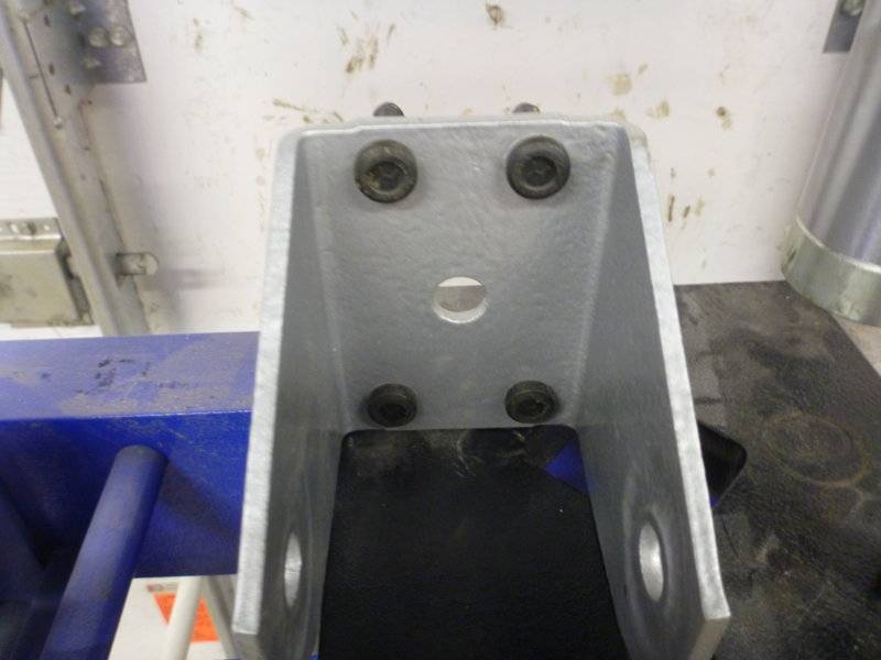

I didn't realize they were welded in. I thought there were just pressed into the hole into the "tapered" star pattern. One of them is out anyway so I thought just pressed in.
Yes Dad'sBee...that is exactly what I want. The bare metal bracket and the black stud appearance. I thought just easier to remove them to refinish.

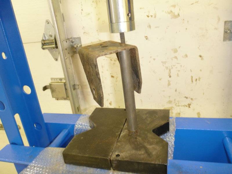

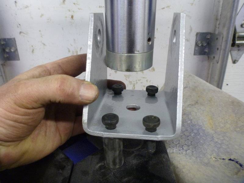

I am fortunate to have a press. However before I got the press, I did use my bench Vice with some success. This one looks to be a challenge because of how the "legs" are, but perhaps if you use a correct sized Socket on the Head side and put the part on the outside edge of the vice, they might "press" out. Slow and steady. Or if you have new studs coming, you can cut the old ones off close to the part and then use a punch with backing on the head side (a correct sized socket) to hammer them out. One of mine fell out while removing them from the car. The others were ok so I just media blasted them and they look/work fine. Good luck on this frustrating job.
I got them out. Actually it was not too frustrating at all. I had a new set of bolts and nuts. A quick smack with a hammer while protecting the bracket and they popped right out. A quick sand blast in the splined hokes to clean them...and the new bolts i pressed in with a c-clamp and a socket over the bolt threads. They went right in!
