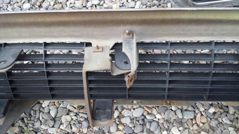

Alcohol will work but go for the 92%. The 70% won't do ****. All those ribs and corners. All those nooks and crannies. Get a stiff tooth brush. Plan on spending several hours. Plan on your fingers getting raw and hurting then plan on going over it again.

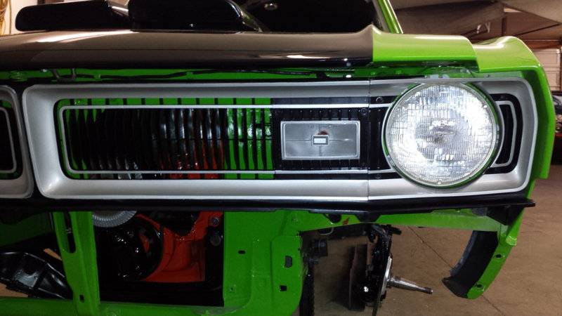

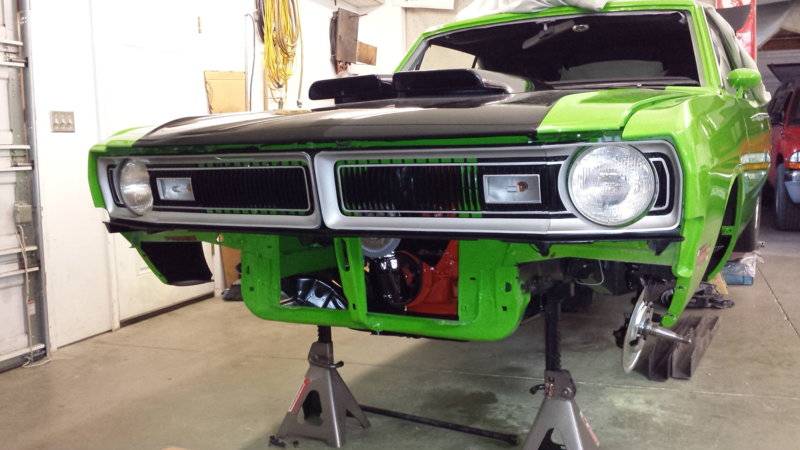

I spent a few hours just cleaning and conditioning the black plastic on my Dart grill. No removal of paint. Then masking and painting the silver.
