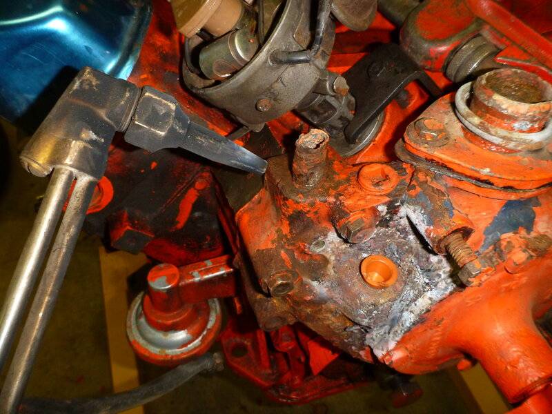

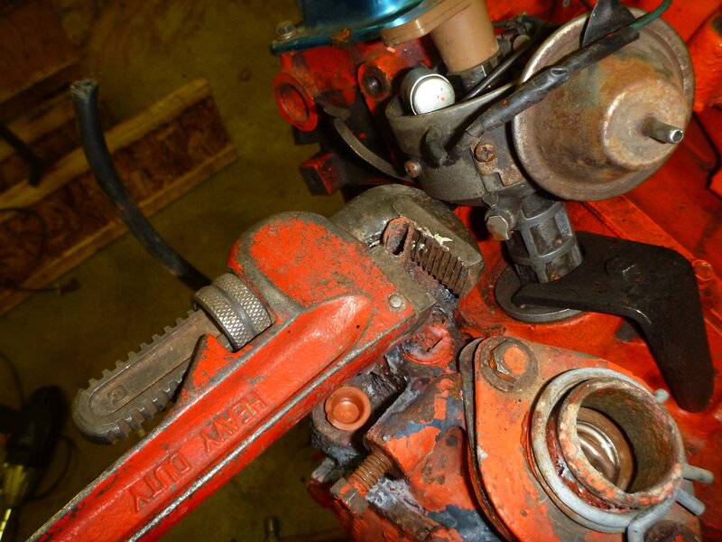

Pipe wrench and the heat wrench unfortunately..
Another option I've used before when needing an easy out that big is to just take some square stock and grind flutes into it.. hammer it in good and turn...
I agree, heat and a 8" or 10" pipe wrench.

That one had been in there since birth.. so 47 years at that point and I was amazed it came out. I didn't care how I heated it..as motor was being blasted and repainted, but heat wrench fired inside the fitting might save the paint and still work!
The small Ridgid brand pipe wrench (accept no substitutes :D) in 8" or 10 mentioned above, AND slide a steel rod, allthread, old round shaft of some sort inside to keep it from crushing. Unless it's rusted through, it will come out. Once it distorts, it's putting pressure on two sides, making it more difficult. The factory tool is like the old drag link sockets, a really thick, wide straight screwdriver.
