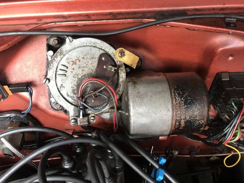

Trying to remove the wiper motor (3 speed) from my 67 Coronet. I e read threads but there seems to be contradictory advice. Do I have to undo a nut that is just barely visible on the end on the motor from inside the engine bay having removed the 3 retaining nuts, or do I have to mess with the clip under the dash on the linkage?
My options are a bit limited as the motor is jammed and nothing on the linkage/wiper arms will move.

Either - nut or clip. Nut is probably easier from under the dash. Snug the motor back down first so its not fighting you.

Ok, from the angle I’m looking at I can’t see the nut. With the motor retaining bolts removed I can pull the motor out and just about see the nit from the engine bay, but only just. would prefer to undo the nut rather than mess with the clip.

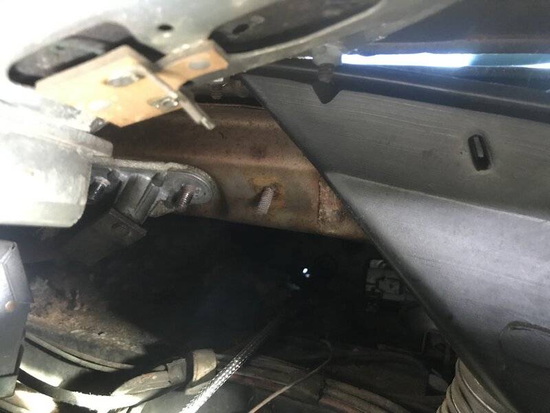

Thanks so, the nut is hidden from sight due to the plate that connects to the linkage as in the first pic?
Sorry for the seemingly dumb question, but I couldn’t see a nut from working thru the glove box aperture.

Look at the mechanism from the driver’s side. Look up under the dash and you will see the back of the motor. Then you can get at the nut.
