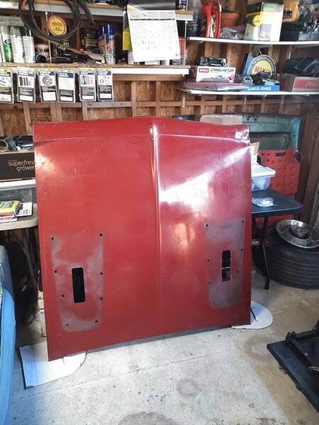

I'm selling a rock solid N96 hood from a hemi Superbee on eBay. $1000. Local pickup only because I tried to ship it to a member but the shipping quote was around $500.
