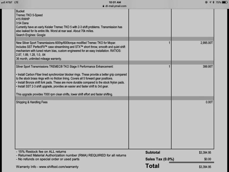

I am getting a quote from SST. On a repair of the current, I was told in the past by Keisler that it is too “early” of a version for the fix that came later.

Getting close to pulling the trigger on the Silver Sport. Already in the $$$$ shithouse here at home. Might as well do it on the heels of the efi. Any other input?
Should work perfect for you, expect some tunnel mods.
Made some minor mods putting the first TKO in. About a 4x4” sheet metal cut. Plus a little dimple do ya. Hoping for an easy install.
I've talked to both Silver Sport and American Power Train about the Dart's Tremec. Both were helpful but I have to give the edge to SST, their tech guy spent a lot of time helping me sort out the hydraulic clutch. Speaking of, the hydraulic clutch is a nice setup.
