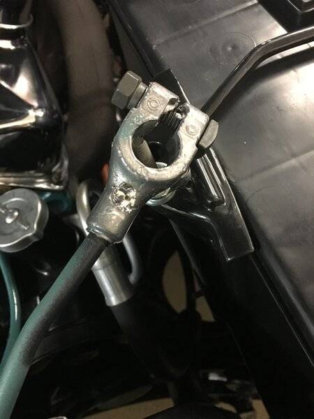

What does everyone use to repair battery cable ends? The previous owner installed one of those cheapo universal ends and I'd like to replace it with something close to factory. Were the factory cables crimped or soldered? I found this end on Mancini, which I thought was an end you solder but, based on another site that seems to sell the same end, the cable appears to be locked in with set screws on the underside of the cable.
Has anyone ever used this style end?
http://www.manciniracing.com/pobarehe.html
Or the Quick compression or solder type ends?
https://images.app.goo.gl/RiV78icUx4uAyGPL7

Those screw in ends from Mancini are junk. If you get one plan on using the screw hole to drop solder into. Mine stripped out but I was able to salvage it and soldered it.
Yeah... Once I realized the cables were secured by set screws, I was a bit disappointed. Glad I figured that out before I ordered one. I may just get the compression or solder in type and just go with something that will be the most secure and reliable.
