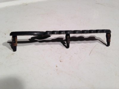

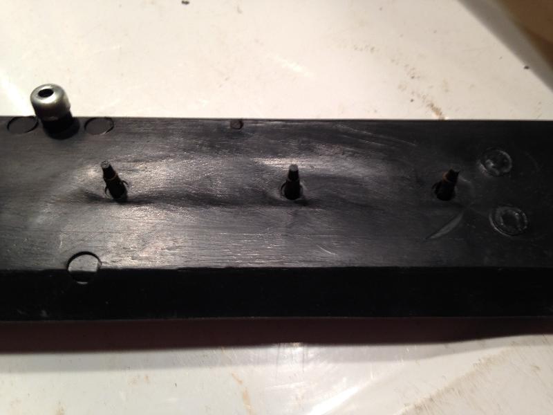

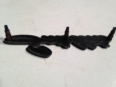

if someone didn't glue it , it will pop off of there. there are three pins that snap into retainers behind the bezel. you might be able to get your hand behind there (with the glovebox liner out) , feel the pins and push them out from behind. either that or pry the old emblem off carefully.
There are three pins on the emblem.
The insert has 7 screws holding it in the dash but there is also the pins in the vents
I dont know how you would go about removing the screws with the dash pad still in as I removed the whole dash pad.
I will go find and edit some pictures for you tomorrow after work
Mine was very hard to get out without removing the whole dash. it had rust on the outer metal pins and I needed to take the dash out anyway, but as you can see from the pics above, you might be able to pry it out. Just be very careful.
