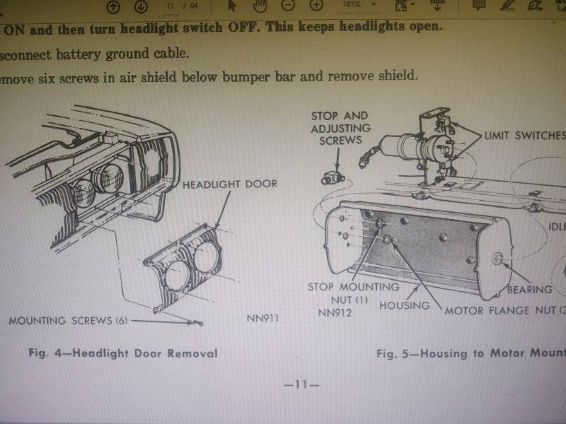

Do I have to remove the entire headlight housing / front grille in order to get to a headlight bulb, or is there a simpler way to do this?
My stock headlights are sealed beam so you replace the entire light.
There are 6 screws, 3 on top and 3 on bottom of the headlight housing to remove the front cover. The grill is not touched. This is on page 11 of the Charger supplement.
Loosen but don't remove the bottom row of screws if you can. On my 66 Charger built in Nov 65, the screws must be removed, on my 67 Charger the screw holes are slotted so you just need to loosen, much easier. Not sure when this change occurred in production
