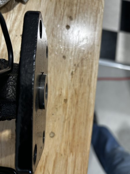

I'm replacing the master cylinder on my 1970 Superbird. The piston on the old master cylinder was flush with the mounting flange. On the new master cylinder it's sticking out about 3/8". Is this okay? Do I need to adjust he push rod in the power brake booster and make it 3/8" shorter? I'm new to the Mopar world and haven't seen this before.
Thank you in advance.
