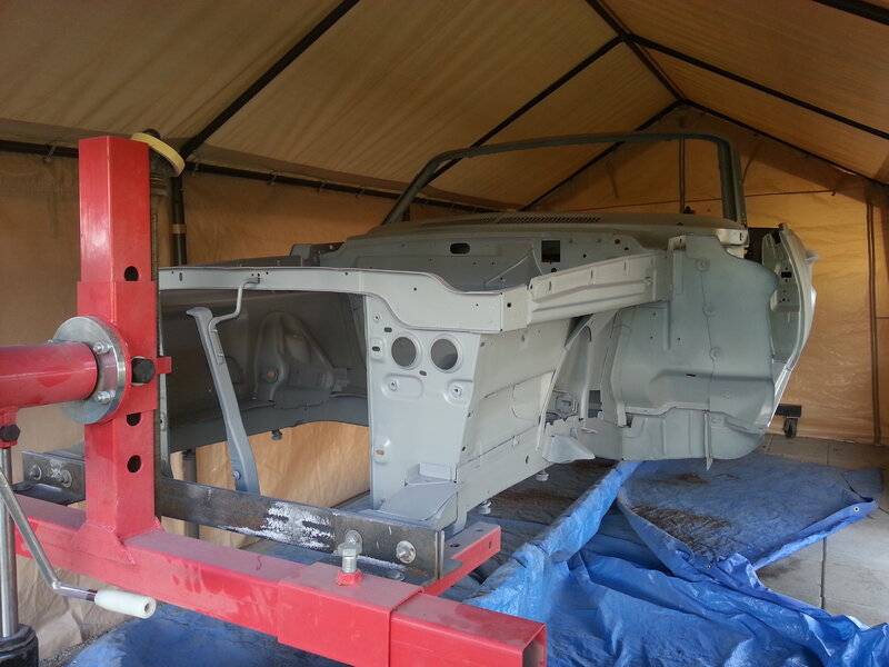

My dad bought the car new but left it in the in 67 when i was born. So in 83 my uncle controlled the car and i was partly involved then he left it 3 feet off the ground in a 1000 pieces. 5 years ago when they sold my grandmas house it was offered to me. It probably save the car. it had surface rust from where he started blasting but never finished and didnt seal. The seats and material must have been in the right conditions in the basement because they look exactly as they were left back then. This picture is how i found it but
Im just now getting to the point where the car is almost done. Vintage air, 4 wheel power brakes, Borgeson power steering, Holley super spark and Sniper EFI. 20160908_184941.jpg
