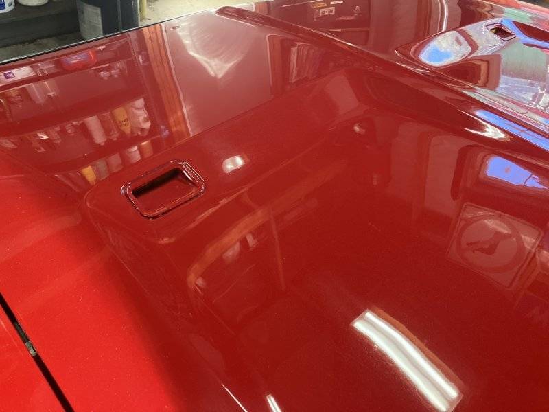

Jigsaw came with a hood from a base model car known as “XH” in the VIN.
It had the housings but no lenses or wiring. It actually had block off plates!

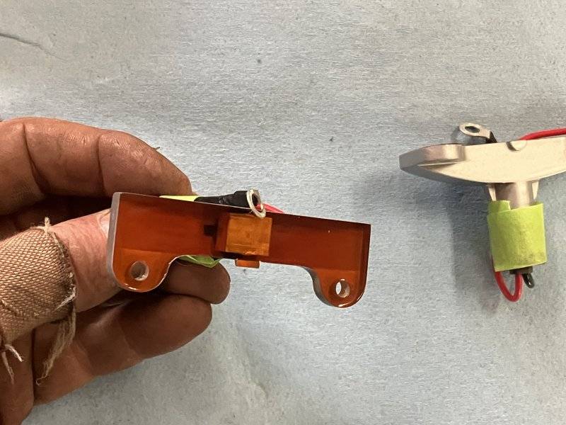

The stock versions look like so:

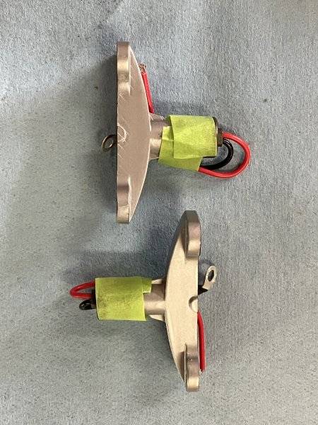

They have one wire and are grounded by a thin strap.

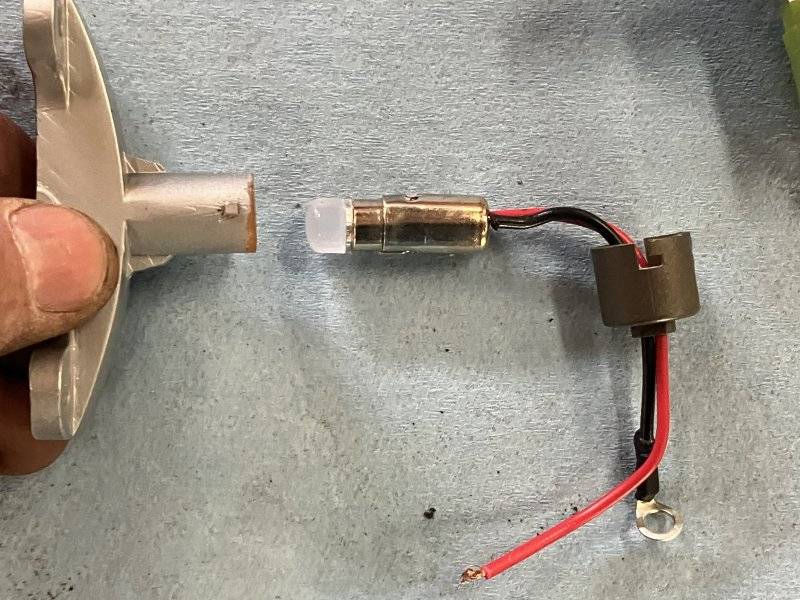

The 3D printed reproductions look slightly different.
They use two wires. One red, one black with a loop terminal on the end.
The plastic bulb cover won’t corrode and unscrews to replace the bulb.
The ground wire is long enough to attach to the stud that retains the lens housings.

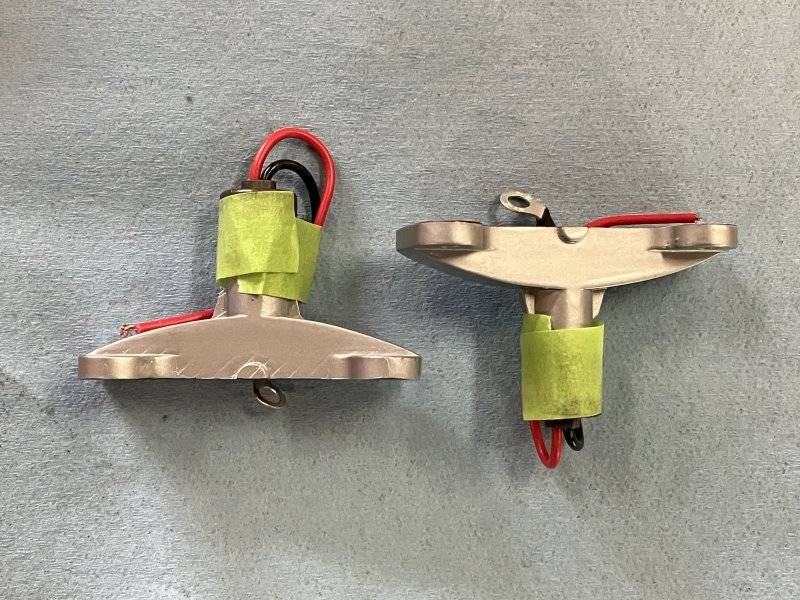

I want to cut the original wires back and put bullet connectors on them for easier removal.
Maybe not...I forgot that once the bulb socket is disconnected that the new arrangement will be essentially the same as the old.
These are plenty bright. I’ll get the connectors and report back when it is done.

Looking great KD ! Thanks for shout out ! I'm happy to help people get that little bit closer to finishing their projects with a little modern twist!
Enjoy the extra brightness and virtually no chance of corrosion . I have started to put just the lightest smear of dielectric grease around the inside edge of the locking cap just to help with the snug fit !

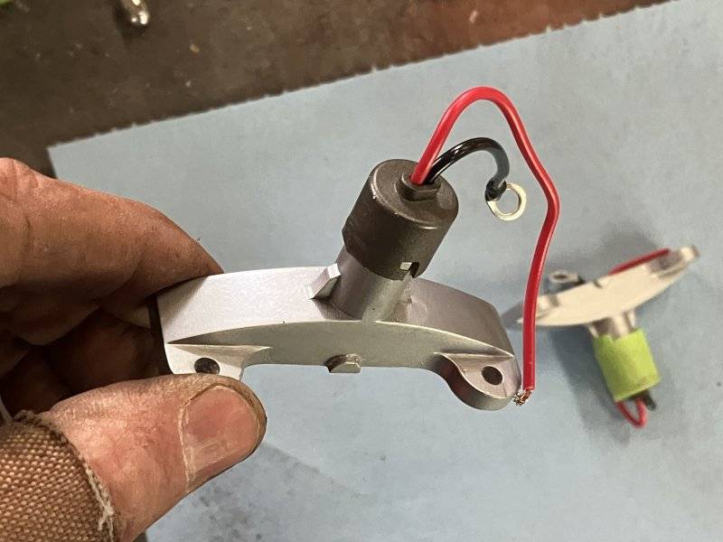

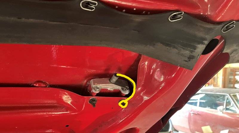

Project complete.

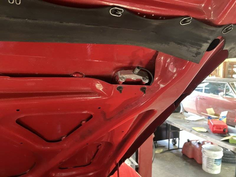

I got these wired and soldered in today.
I was in error though. I thought that the black ground wire was long enough...
To reach the hood itself where the outer housing attaches:
Another 3/4" on the wire would have made it. No problem though. The screw that retains the bulb arrangement provides adequate grounding for the low demand LED bulb.
