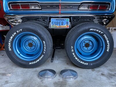

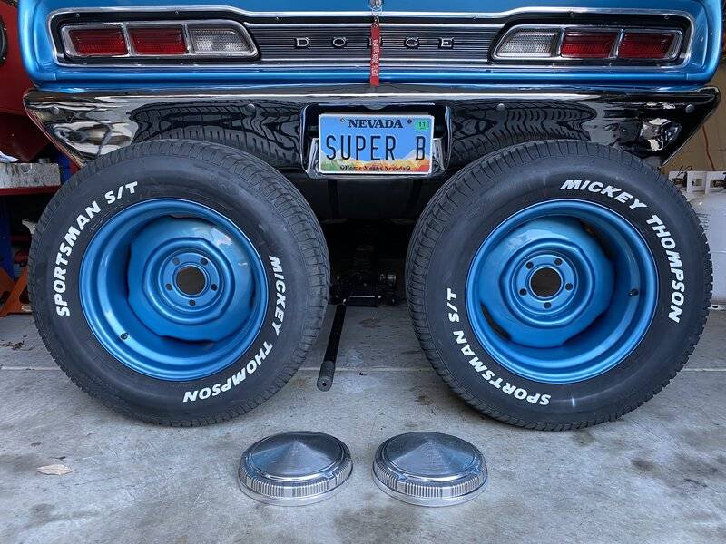

I upgraded my wheels, 15x8's and 15x10's after market steel wheels from summit. Over all I'm happy with them and love the stance. Only complaint is the factory dog dish caps don't fit well. On the factory wheels, there are 4 "nubs" that hold the caps on. The aftermarkets only have three, which required a little massaging (grinding) to get the caps to snap on. I did apply some glue to them as a secondary precaution, but in the end, I now run them without the caps.

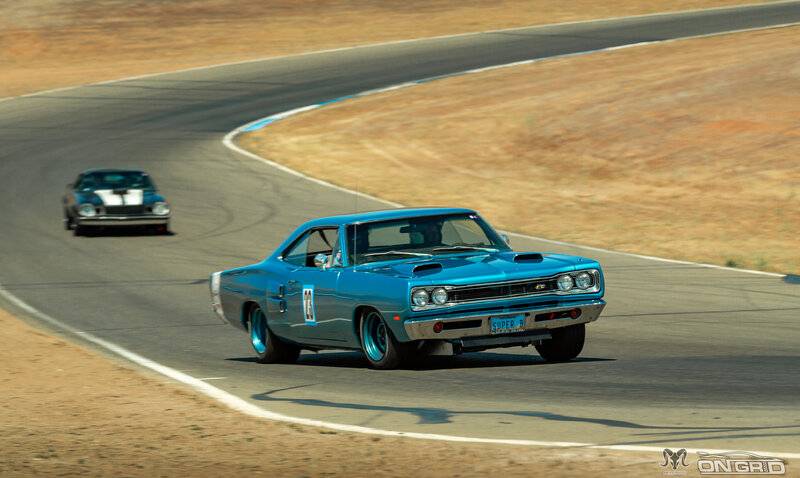

P.S......I have run these wheels on a road course race track with some hefty loads appied to them. They are pretty strong with no issues.

At one time there was a problem with the aftermarket steelies not holding the dog dish cap on.
Some are 3 lug for the caps,others are 4.Factory Chrysler used both.
Maybe someone will chime in if the problem was corrected.

Got a set of 15x8 made by wheel vintiques through Summit. Nice quality, holds the caps with no problems.

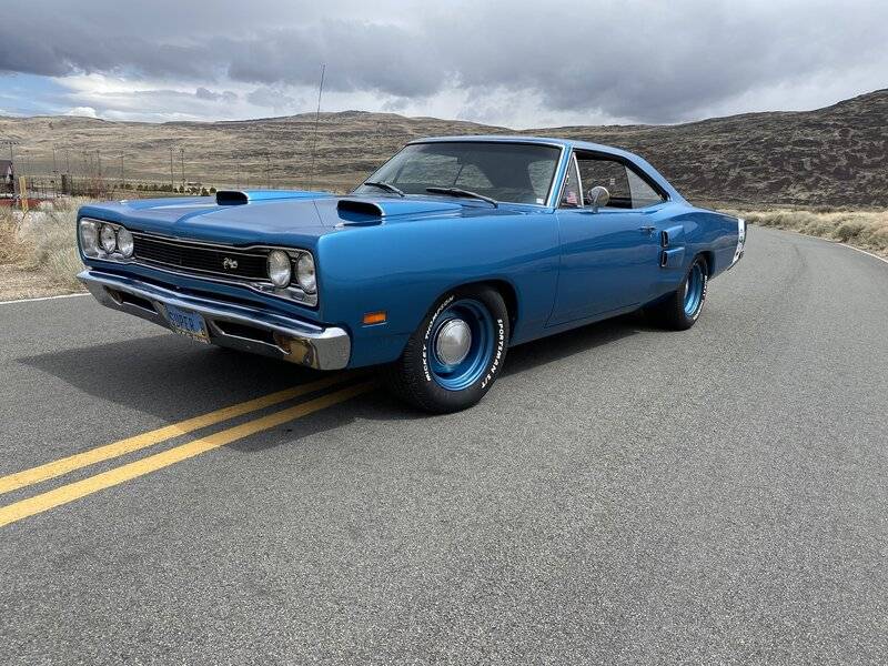

Here's my setup with part numbers/prices from Summit Racing....
Tires/Wheels
Front wheel 15x8 Part #63-5812042 $126 x 2
Front tire 245/60R15 Mickey Thompson Sportsman S/T $146 x 2
Rear wheels 15x10 Part#63-5012052 $182 x 2
Rear tire 295/50R15 Mickey Thompson Sportsman S/T $190 x 2
