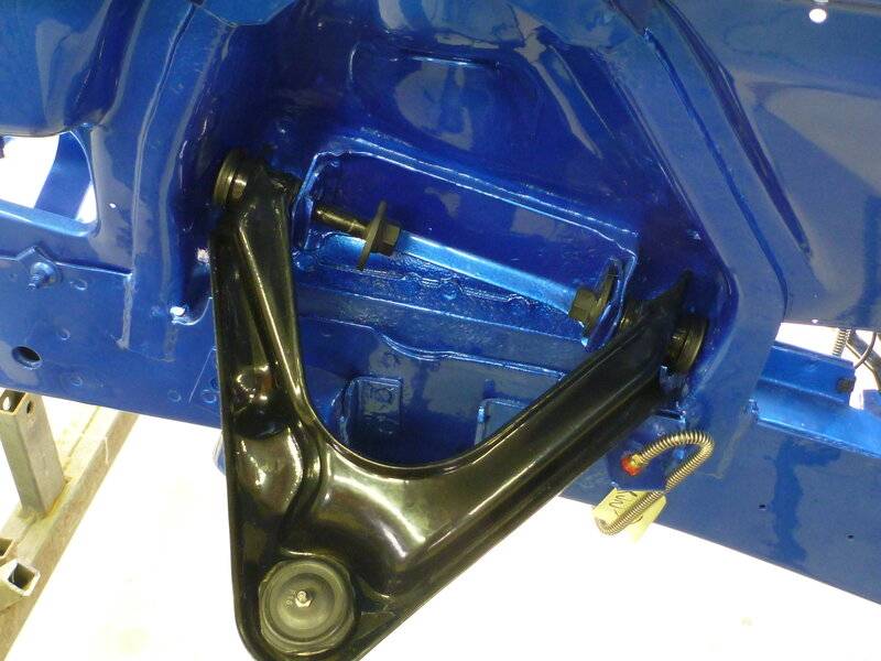

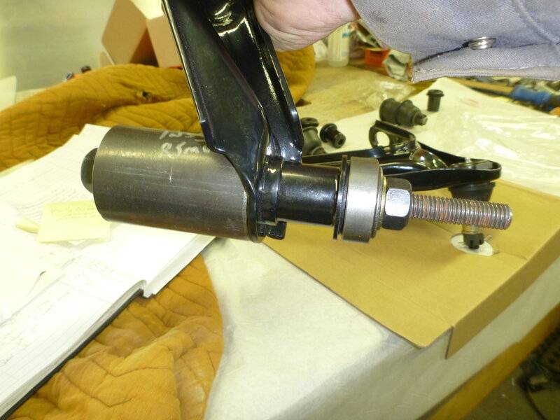

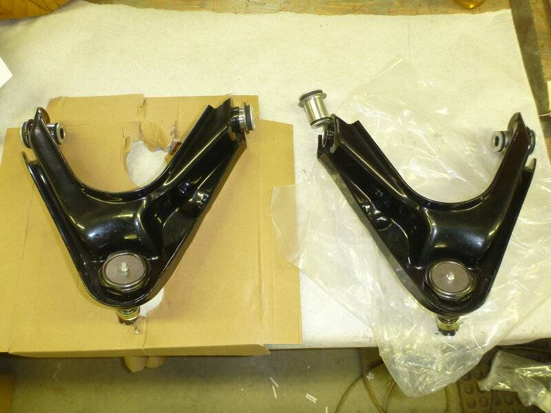

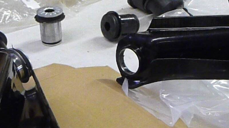

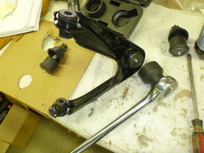

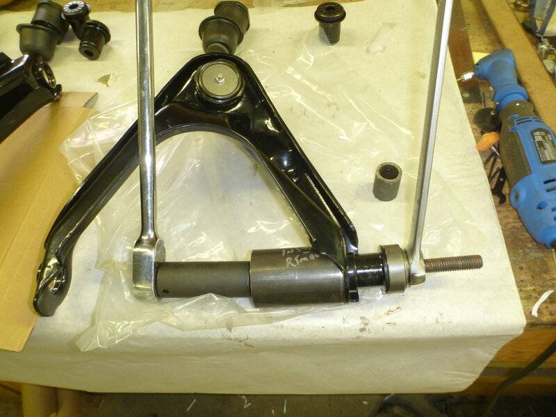

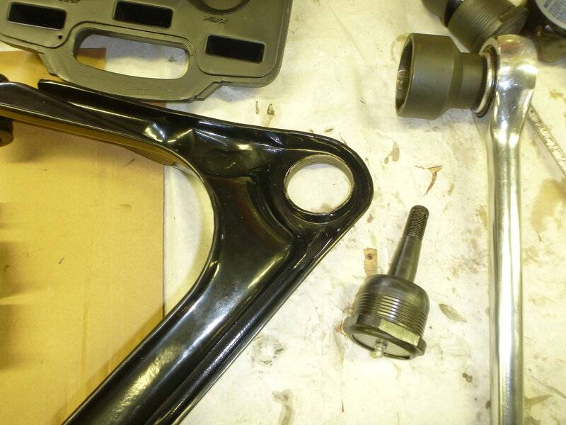

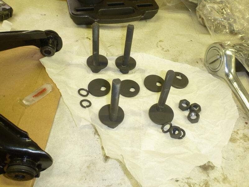

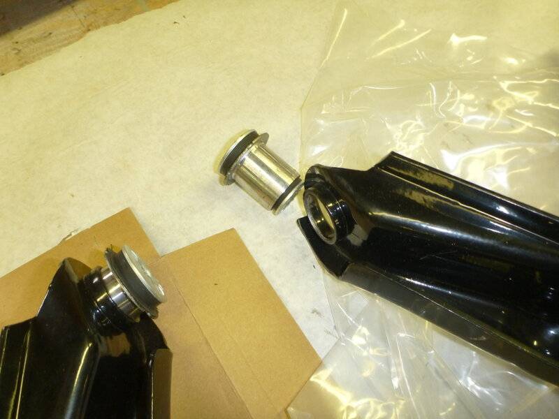

I used reproductions restoring my Bee as my OE's were beat. The reproductions themselves were good and powder coated, but the upper control arm bushings are junk.. pushed them out with my fingers and installed new ones from PST. I also replaced the unknown ball joint with PST's for safe measure. What was there was probably fine, but I had the entire front end kit from PST so why not.

Thanks for the detailed pics ! Yes my concern was the fit/quality of the bushings in the control arm, and also the quality of the ball joint. The steel stamped factory arms I am working with are in pretty good shape. I think I will just clean them up, re-spray them and install good quality parts. I appreciate the info. !!

Life is a lot easier with the bushing removal and installation tool shown.
If you're changing the upper ball joint do it with the control arm still on the car, it takes much grunting to break it loose. Start the new joint by hand to avoid cross threading. Upper ball joint takes a special socket.

Where did you get the bushing tool?
PST also has the repro control arms and a 10% discount for members here, they have a click ad on the main page which takes you to their site. And the socket tool as well $48.00 I think it was.

I bought the repops. Looked pretty good. I swapped out the bushings for moog offset bushings. Also replaced the ball joints with moog. ISSUE- One of the ball joints (left side) was cross threaded so threads are shot and my new ball joint won’t tighten up. Sucks.

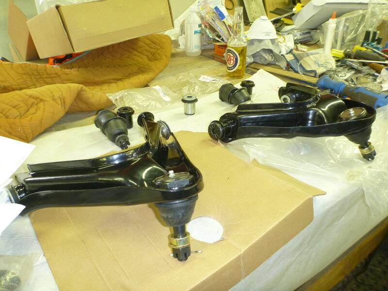

The cheap rock auto sets look great but fit is not good. A waste of money. They rub on the frame tabs at the inner bushings and the bushing that comes with them is 3/4" inside diameter instead of 1/2". I fail to see a difference in these cheapo arms and the over priced ones from name brand sellers....maybe a grease zerk. They are around $400 a set. rip off. The do not allow any more caster and they are heavier the stock arms. I bought them as a time savings over rebuilding the stock arms. I finally rebuild the stockers and am WAY happier. I just cant get much caster at alll.....max at 1.5 degrees. oh well. 1971 Coronet.

Get creative...I used all thread and an old crush sleeve with a few washers. Muscle building exercise for sure. The biggest issue is the socket for the ball joints and ratchet. Nice having mopar buddies to borrow stuff like that from.

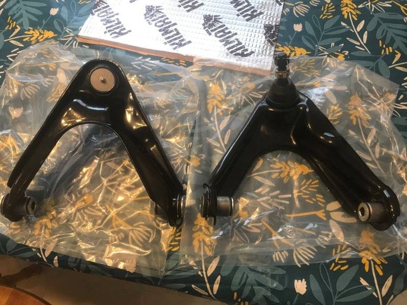

My new set just arrived at the doors not 5 minutes ago. At first glance they look great. After reading what Wayne wrote about the bushings. I had to check them out first. Tight, very tight. As far as I could tell. So the new offset bushings pushed right into the "reproduction" control arms? Also the new balljoint screwed right in? No problem? So if a fella had to rebuild these the specs/dimensions are the same??

The offset bushings pressed in fine. I found out through research that my stock ball joints were not cross threaded, but that they are a different thread than the Moog upper ball joint. One of mine torqued to spec, the other stripped out.
