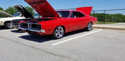

Thanks so don't know but my 70 rr caged&tubbed ,fuel cell ,i have ahot 413 air grabber set up ,six pack and plan on making it red paint and big cartoony roadrunners on quarters and custom dust trail stripes removed front half of cage

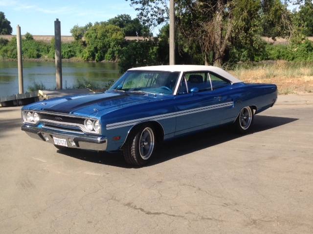

THIS is a Pro Touring build. 5.7, Nag1, alterktion,4 link, 4 discs,17" Torq Thrusts. 18mpg all the time, reach in and turn the key to start. Looks very stock.
My opinion anyway.

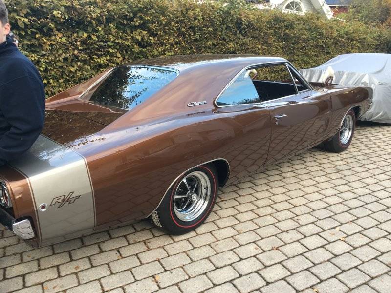

-68 Charger with a 2016 5,7 and a Tremec 6 speed
Maybe its a restomod after all?
