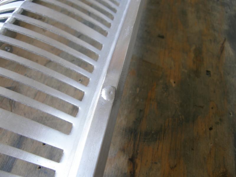

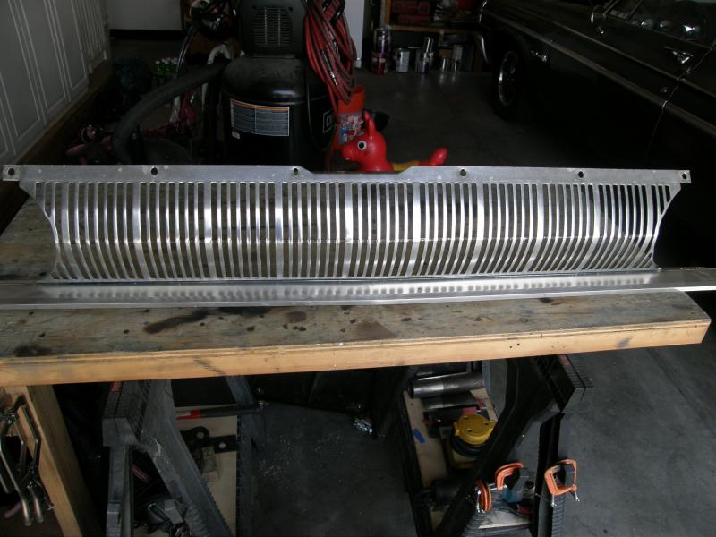

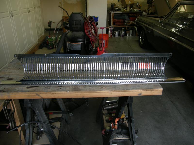

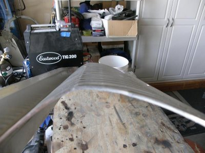

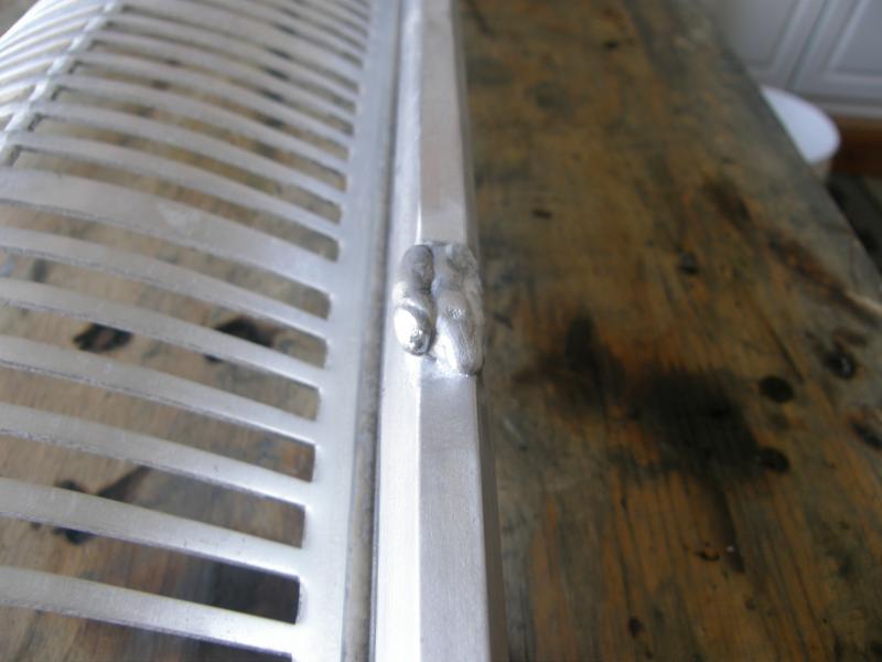

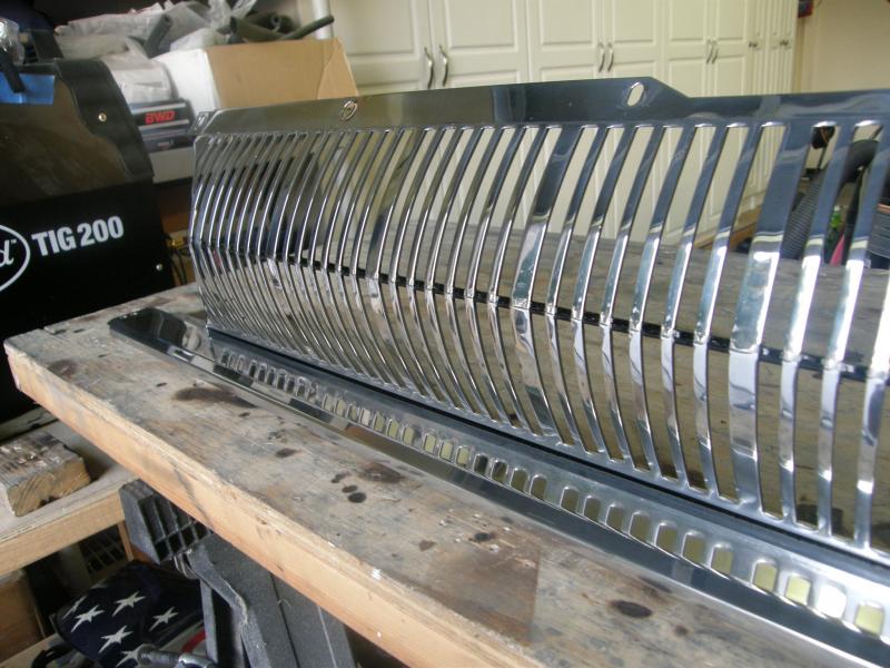

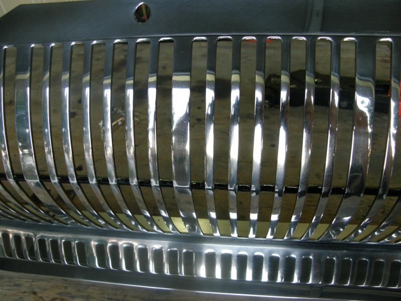

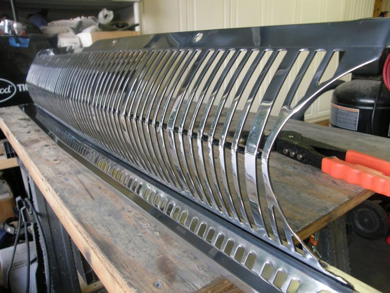

I started with a grille that needed some attention to the vertical bars, slight bend and 2 dings in the front, 1 of which was pretty bad even after I knocked most of it out so it was tig welded (I built it pretty high so I could sneak up on the right height), the other ding just neded a small weld to fill it. The brackets are drying and will get put on in the morning. I did this grille for those just wanting a factory look and not a superstock conversion. I'll post it in the for sale section if anybody has an interest.
