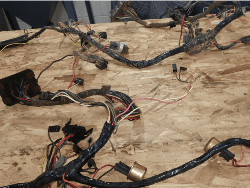

This pix shows both a '68 and a '69 harness both from GTXs If you look closely both have a "fabric" tape wrapped portion near the bulkhead connector and the rest is wrapped in the smooth "adhesive less" black tape. I was surprised when I noticed that detail.
