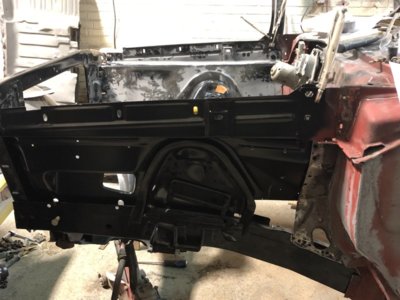

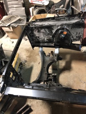

So after 2 years getting the chance to continue my abandoned project & wanting to know which restoration guide out there is good that would have all the measurements for body/frame etc?
Putting up the frame rails which is pretty much done now mocking up the front end..inner fenders-shock tower-rad support etc..

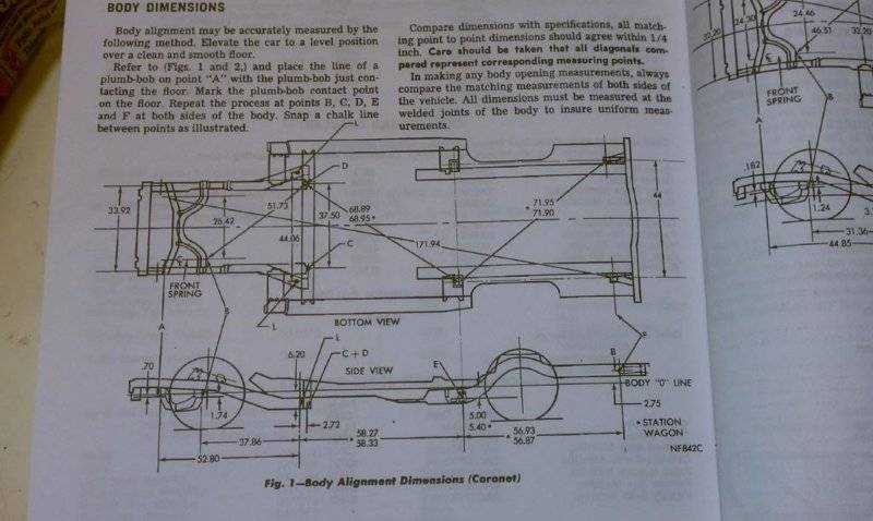

This may help. It is for a 68 charger/coronet but should be the same for 70. Use it on level floor.
How about 6 inches?, above your post... Can you not read the numbers?. Copy, paste to desktop and click on the magnifying glass.

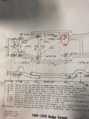

I’m clicking on it and it’s not opening and when I try to zoom it’s blurry.
I’ll try from a desktop I guess
Ok so the numbers I need aren’t on that.. Please check the red mark I made.
I need from the tip of the front rail to the other end (guage hole)
The problem I have is that the current rear rail guage hole is patched up/closed (previous owner). So I’m not able to measure
That’s why trying to get some additional measurements
Oh ok, I was wondering why that wouldn't work for you, sry.
