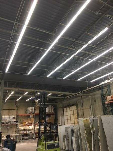

Throw that old crap away , get new units that are full on led there's basically nothing in them and there very bright. They run cooler too. It's just 3 wires you need to disconnect and reconnect to new unit very easy ,you could turn power off if you want too. I just leave switch in off position and no shocky shocky!
had a friend send me this ,that is where he got his ,craigslist add https://cleveland.craigslist.org/tld/d/led-lights-shop/6592193409.html
Cool, I am going to have to check this out, when I can. Got a 2 car garage, that is double length, that needs better lighting. I just have to come up with some bucks. Got things ahead of my light project, you see.
