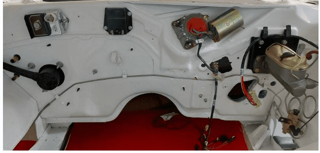

bee71, here is a pic of my firewall - slightly different than the one you posted.
My car did start out life with an auto transmission - I converted it to a 4 speed setup.
I assume that I may have to drill an additional hole in the firewall for some of the harness to go thru?
Doug - thanks for the schematic. What say you about needing an additional hole in the firewall?
In ’71? Hole in the firewall? Just for the dash mounted reverse indicator light’s wire and gromet. Connects to the pigtail in the above diagram on the engine compartment side of the firewall. Bee71's pic above shows the reverse indicator light wire grommet location.

Refer back to the pic I posted. E and B body firewalls are the same. Look at where the hole is. If you are going to get the wire you want to be pretty close to that location as it feeds around the torque shaft on it's way into the underside of the dash.
When no hole opened at certain sheetmetal location for any non added accessory from factory normally a dimple can be found on spot.
not really. REALLY CLOSE but not exactly the same

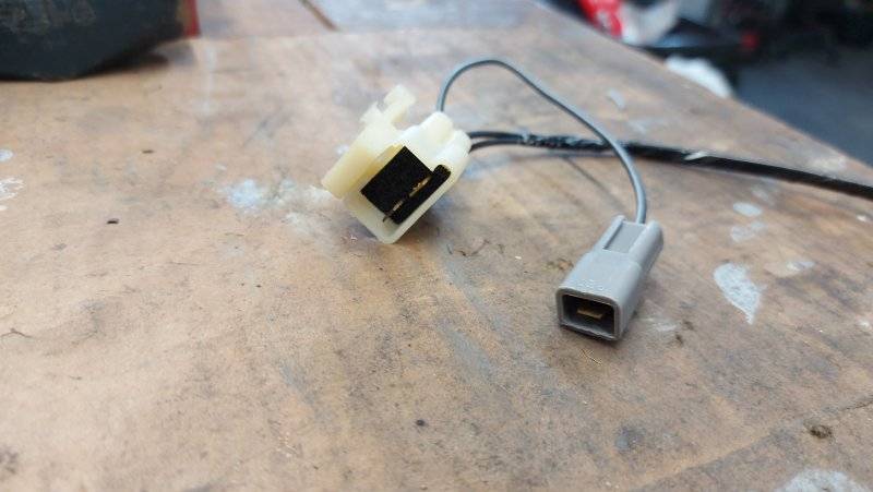

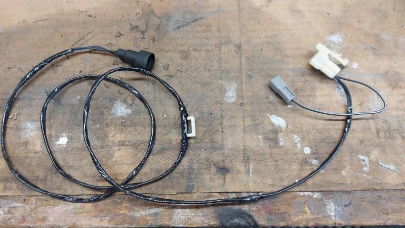

Okay, I was able to get a few pics of the wiring.
I will take T2R9's advice about tapping into the cavity 7 on the diagram 72RoadrunnerGTX shows on the interior side of the bulkhead connector.
That way I do not have to put any more holes in the firewall.
So I tapped into the wire at cavity 7 - no issues.
