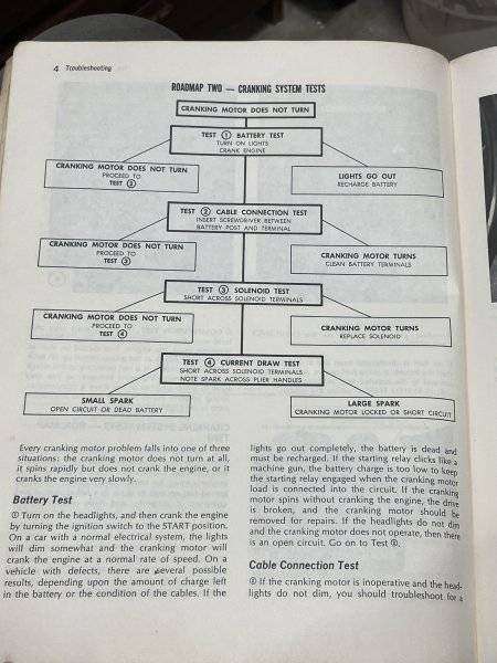

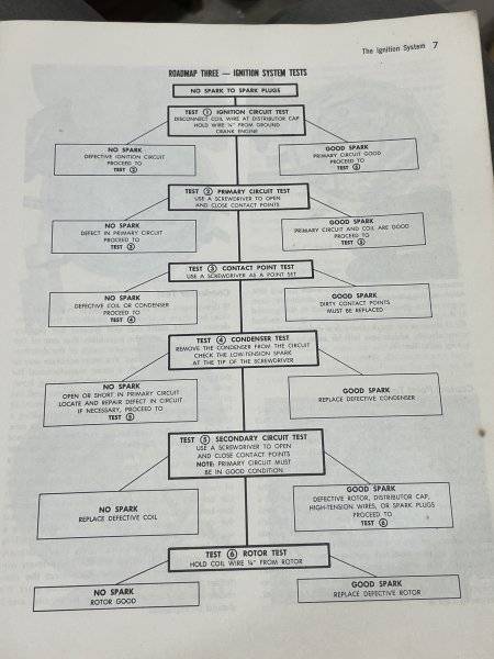

There’s Troubleshooting, Tuning For Performance and the rest of the usual topics. It’s a well written guide, has really decent pictures and covers 1955- 1971.

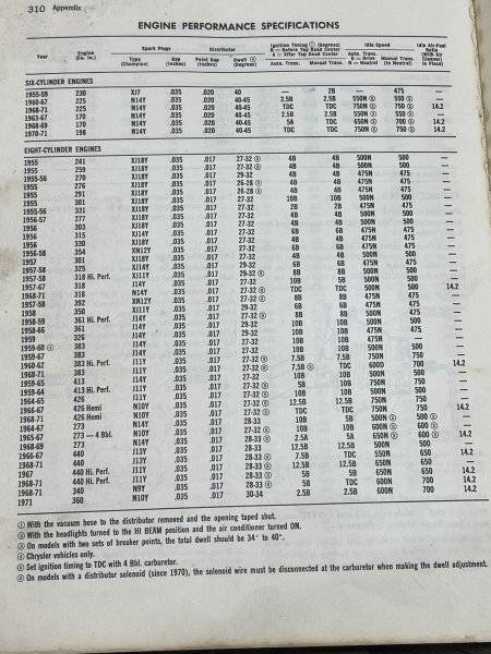

Here’s a few photos and the 413 used J14Y in the standard engine but the HP version used J11Y.

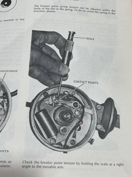

I never seen the ignition points spring gauge. Anyone here use this spring strength meter?

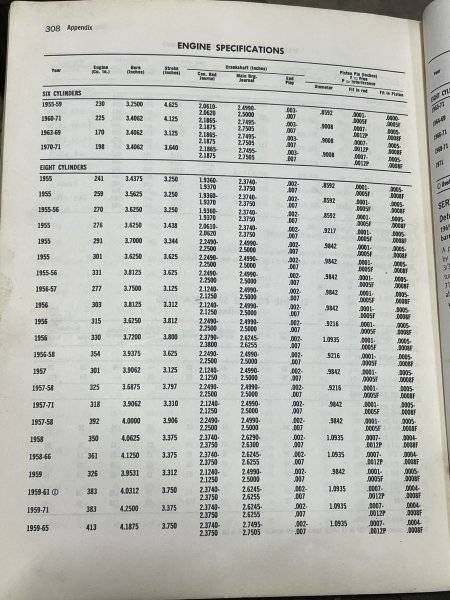

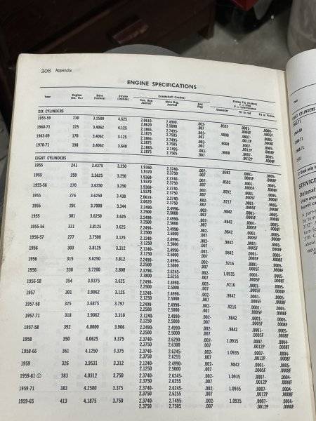

I always wondered about the early V-8 cubic inches of Chrysler engines because there were “odd ball” sizes.
This book gave me the answer in one page. For that information alone I give it **** stars out of 4.

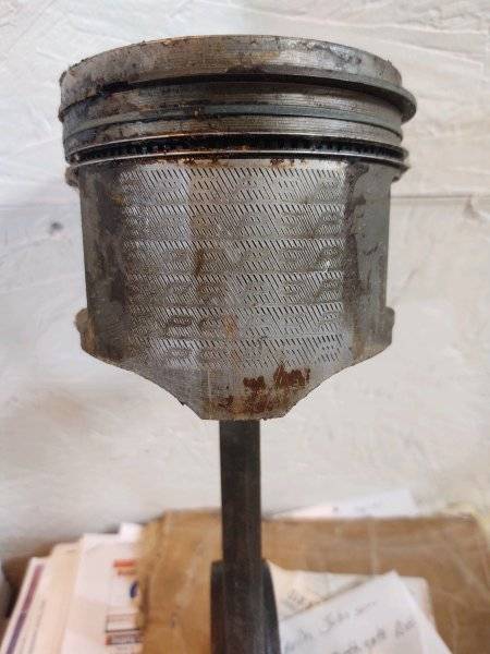

The motor specs pages look quite identical to a Peterson Motor Book... wonder if it's a coincidence?? Very cool old school info... certainly never, ever heard of mechanics sending out NEW pistons to be knurled???? But I'd bet you could probably do it with any TRW or SealedPower/SpeedPro slappers lol.
The Motor Books are great too.
I had to re-read the knurling part and it says it’s useful for a lubricant reservoir.
I had 383 pistons knurled for a stock rebuild and I know it would tighten up the cylinder clearance but understandably it wasn’t for longevity.

Just for giggles... I found an old street wedge piston from a 426 we are redoing.... the whole set was knurled, just like the pic in the book.... vintage for sure... Can anyone explain the markings of the knurl??? Proprietary I'm sure.
