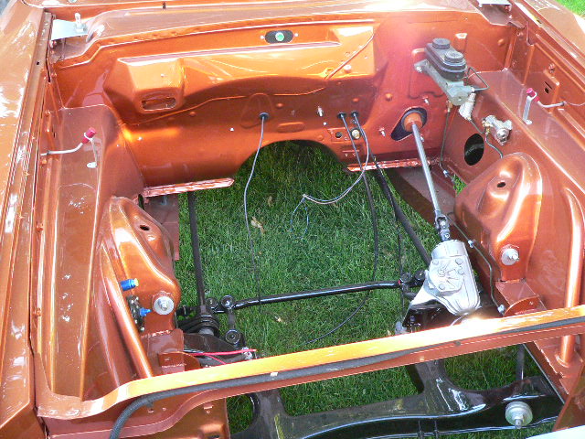

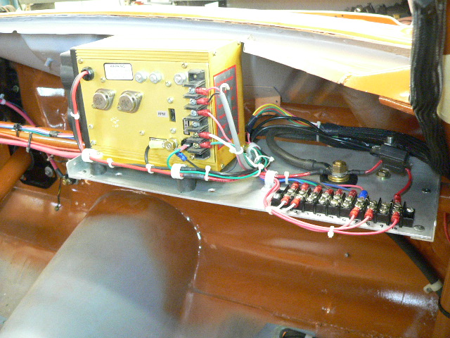

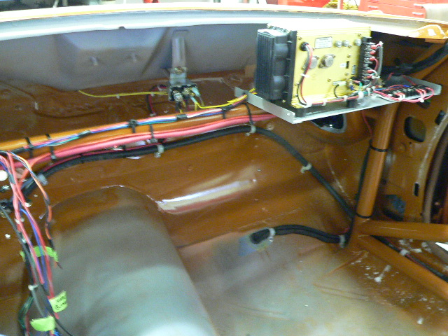

I did mine like that. Built my own harness. It took about two weeks. Wiring goes through floor pan into right front frame rail and comes out just behind the motor plate tab. Relays attached to the motor plate for fans and pump. All holes are welded up in the firewall.
Doug
