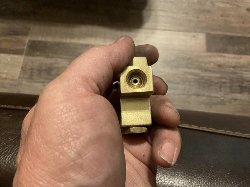

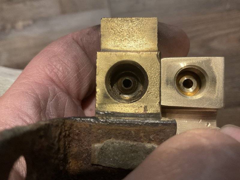

Never will understand why someone goes to the trouble to reproduce a part and doesn't get it right! I guess the Chinese lose the specs in translation check out the pics of the flare seat in the new repop compared to and original brake valve.
It does not match the flare at all in fact the only contact is on the very outer edge of the flare on the line
Here you can see where the only contact is after tightening the line in it.
I posted a want ad hoping someone has an original or a correct one available it’s the last piece I need to get my brakes done.
So your saying they sold you the "wrong stuff"?
I had issues with parts from inline tube. leaking valves from day one. got a new one from dr diff. not an OE but no leaks. Rotsa ruk
