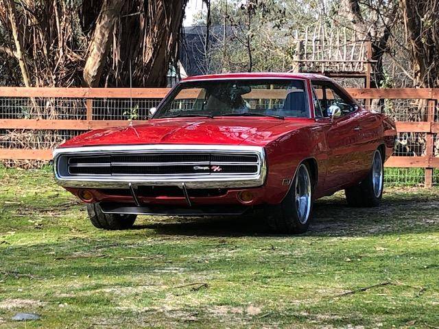

This car......
Has 18 x 9" front wheels with 4 3/4" backspacing. 275-40-18" tires.
18 x 10" rear wheels, 4 3/4" backspacing with 295-35-18" tires.
From 2003 to July of this year, I ran a 295-45-18" rear tire and I would get tire rub on the outer wheel tub at the rear.
68-70 B bodies have a weird bulge in the outer wheel house that intrudes into the wheel well.
I modified the bulges in this car as well as with my "Jigsaw" Charger.
Increasing rear tire clearance in a '70 Charger.

This car......
View attachment 1377759View attachment 1377760

My tires were 28" tall and with MP 440/Hemi leafs and a 1 inch lowering block, I'd get rubbing when I hit some bumps. No lowering block and I'd rarely touch.
Now with the wheel well mods and shorter tires, it all clears.
