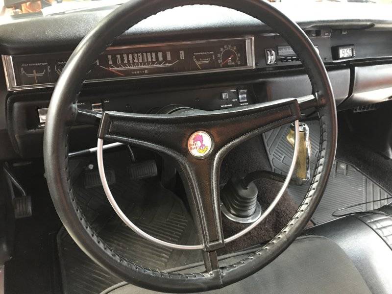

My 69 Road Runner has the three spoke “rim blow” horn.
How do I remove that, in order to remove the steering wheel?
Sorry, it’s technically not a “rim blow”.... I have the “horn ring” around the lower half of the steering wheel.
Pull out the center medallion. There is a small nut under it. I think 7/16 remove that and the horn pad and rim will come off. My video below.
Ok, ...got it already... had to destroy the medallion, unfortunately :-(
