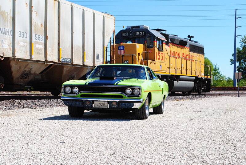

I have 15 x 8 rims with 4 1/2 backspacing. Front tires are 245/60R15 (no that is not a misprint, they fit fine) and 275/60R15 in the back. Take a look to see if that is your cup of tea...

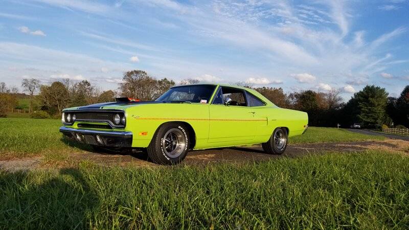

I had 15x8's (chrome reverse) under my 69 road runner. No mods of any kind. however for about $70 you can get a tool that will answer your question and allow to give to a supplier the back spacing you need so it clears. I have 15 x10's inside the wheel wells of my 66 satellite. find it on line: Percy's WheelRite Tool

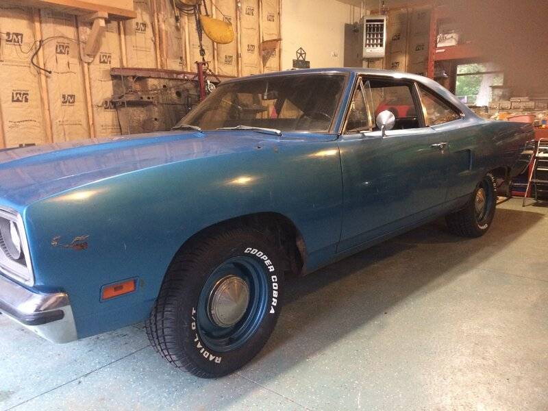

I opted for what my brother calls “5th Ave. wheels”, because they come on most all mid 70’s 5th Avenues. They were $12 a piece at the pick and pull, and they’re 15x7”. At that price point, they’re perfect for me and my budget minded look! Tires are 245/60/15
