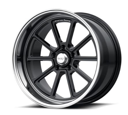

I think I can accept the look of this rim -
Kinda sucks seeing it on Toyotas, but I doubt I'll see another one IRL anyway.

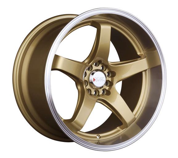

The XXR 555 comes in three sizes -
17 X 8
18 X 8.5
18 X 10
The backspacing of the 17X8 is 5.88 inches. Too much for front and back? The others are even higher, 5.73 and 6.48 inches.

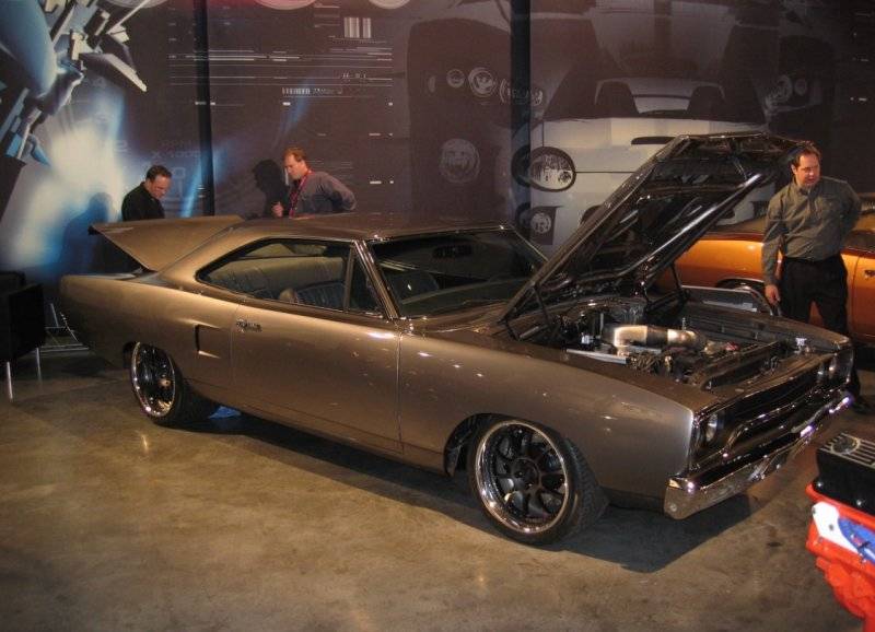

I have a few pictures of some bodies and bodies with some big wheels

I prefer the XXR 555 I posted, if it will fit. If nothing else, it's more affordable than $4-500 rims. Takes some of the hit about it being not-quite-perfect. Whatever I end up with, someone will hate it anyway. A few days ago I talked to a guy who hates slotted mags. Hates 'em. I guess it takes all kinds . . .

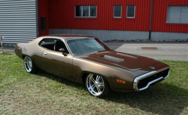

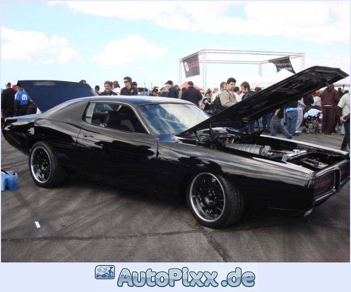

perfectly good look on a modern muscle car -
The modern Challenger is not a whole lot more modern looking than the 3rd gen Charger.
You could almost sell this as the next modern Challenger -
I think that rim is Year One's Rallye for the modern Challenger. I don't think it fits without adapters. If it did, it'd be a stronger contender.
This doesn't look bad, but a bit large for my taste-

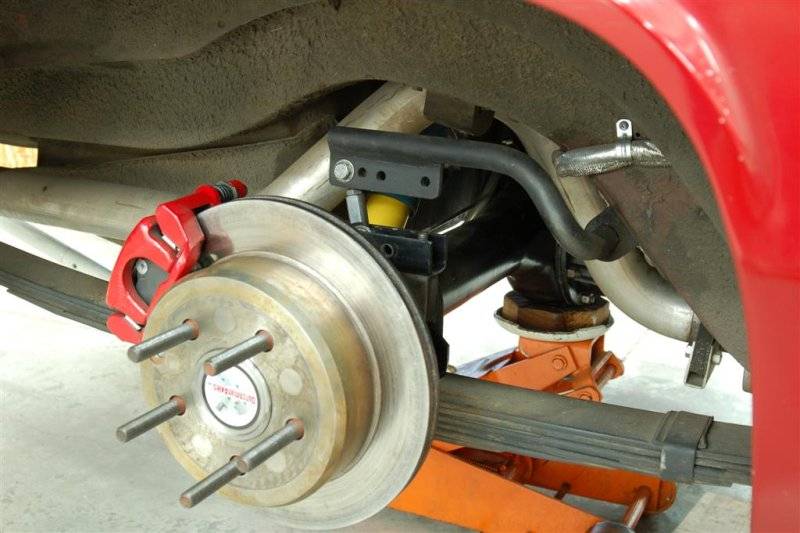

I think the 6 1/2 backspace is too much, and the tire will be against the leaf spring.
Unless you move the leaf springs. I wouldn't move the springs just to use a particular wheel.
I would move the springs to get lots more tire under the car.

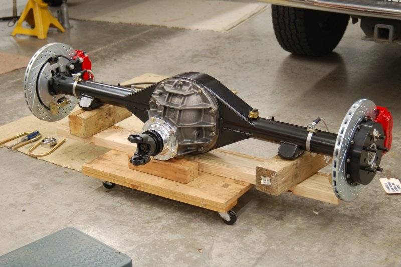

You need to measure the car to know what backspacing is required to fit that tire in the wheel well. Once you know the required backspacing you can figure out the spacer dimensions. Typically Mopars want 0.50 offset so a 10 inch rim would have 6 inch backspacing and 5 inch of front spacing.
But that is just the rule of thumb, when you are trying to cram as much tire as possible into the space you need to actually measure it. And be sure to measure both sides since Mopar rarely built the cars perfectly centered.
If your car needs 6 inch backspace then you need to fabricate a pair of 0.480 thick spacers. They should be hub centric so you need to measure the wheel hub and the brake hub and take all of those dimensions to a machine shop.

I imagine a nearly 1/2" spacer would require longer studs as well.

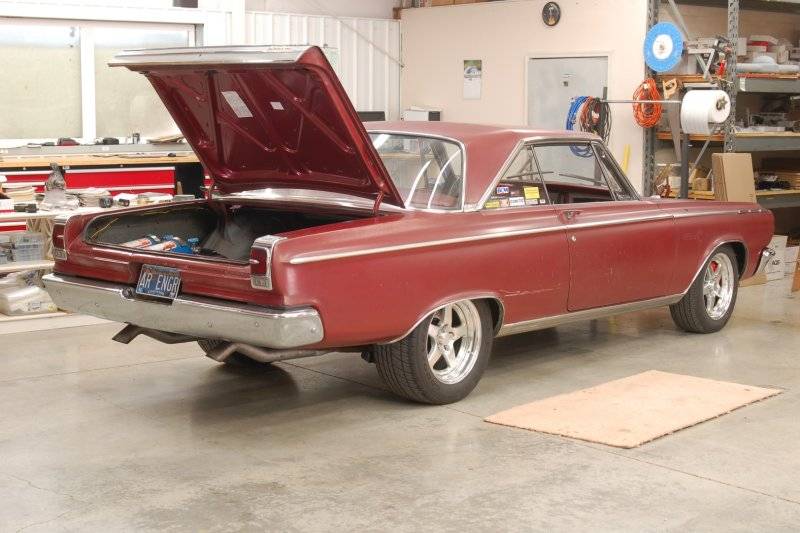

Makes me think I could live with something like this -
Especially if it would take a spinner instead of the little chrome center cap. I have no idea how spinners install.
Yes, the wheel studs need to be longer. When you do a custom rear end you narrower it a little more than it needs and then you install long studs so you can use spacers to put the wheels exactly where they need to be.

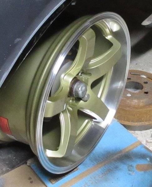

Ordered your book today, but can you give me a heads up on how to solve the problem with the dust cap sticking out of the rim -
I've only found one 2 1/4" diameter center cap so far, from Coker, out of stock at Summit and kind of pricey for what it is.
BTW I don't have a spacer behind this 8.5" rim yet. That will help, but not enough.
