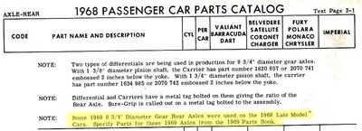

Do you have the fender tag for the 68? Post it here. It will tell what rear ratio and SG or not. A sure grip was an option on most cars without a Dana 60. 1968 performance B body would have a 2070742 case.
https://www.hamtramck-historical.co...DataBook/1968/68_Super_Bee_Suppliment0004.jpg
No sir, no fender tag on my car. My vin tells me it was a Lynch Road offspring. The case is a 489……I pretty much knew right there it wasn’t what the 68 Super Bee should have. Put this component with the engine and transmission that aren’t numbers matching either. It’s still an original 68 Bee, which in itself, is worth saving. The only thing that is correct in that rear end is the gear ratio…..3.23, which I assume were good enough with the 383 and 4 speed….just can’t see myself doing one wheel burnouts, after all this work……
