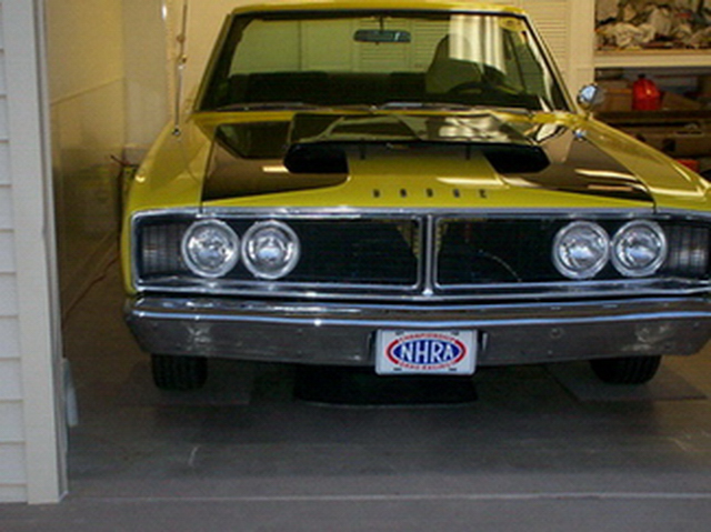

I got my scoop from Sled City Fiberglass (614-875-0369). I met Larry at nationals and he was a good dude. I paid about $130 but that was about 2002. It is a good quality piece and has all bolts molded in. Easy install
Wow...thanks for the great picture. I will check them out. I would assume you made it functional. What engine intake setup?
thanks...
Yes it is functional, I cut a hole in the hood with my trusty jig saw. I have a not so mild mannered 440 bored 60 over with a with a performer rpm intake and an 850 speed demon.
Awesome, thanks for your input, love to see more pic's of your car...obviously a Coronet, love the 66-67 B-Bodies...
