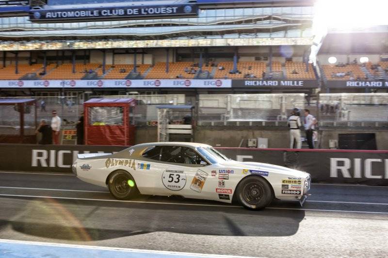

Anybody road race? That's where I need some advice
