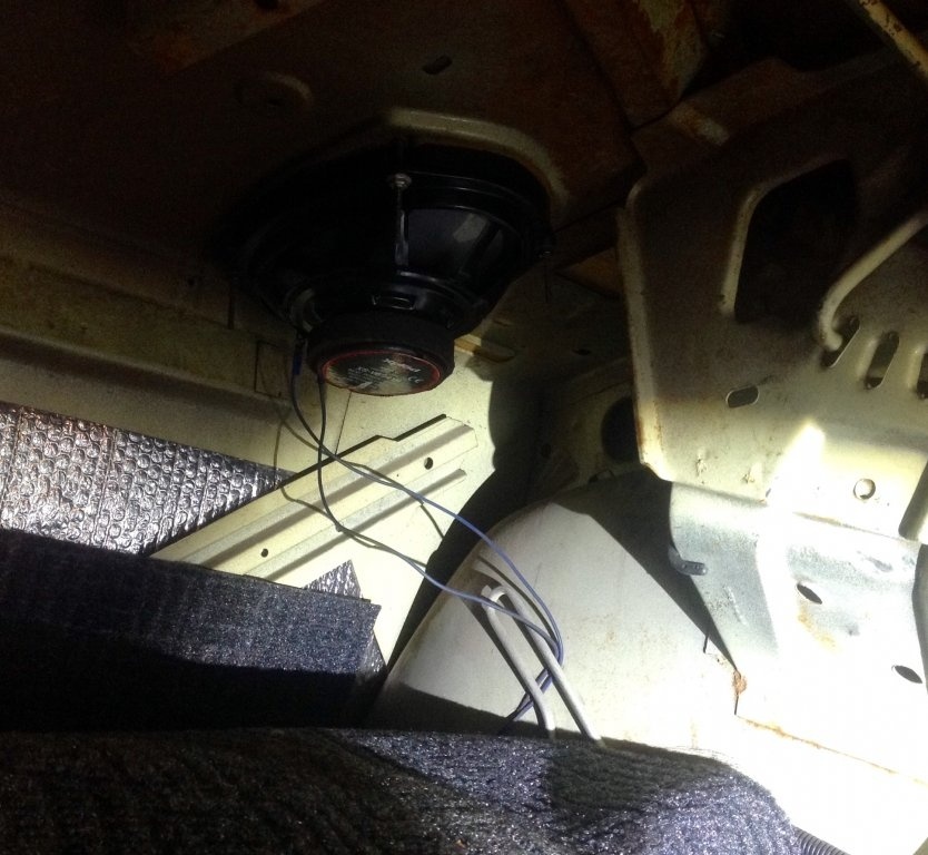

Finally got mine atraightened out. When to a hot place this weekend. Filled tank to brim, parked on an incline. No fumes, no purging. Fuel gauge works. Tried so many things to get it this way, can't remember how to explain it except to route the vent high inside the trunk. Got a 70 tank in my 69 so it has an extra vent that is plugged. That because of asshole MoparEd (Central Valley - not tn, different Ed).
