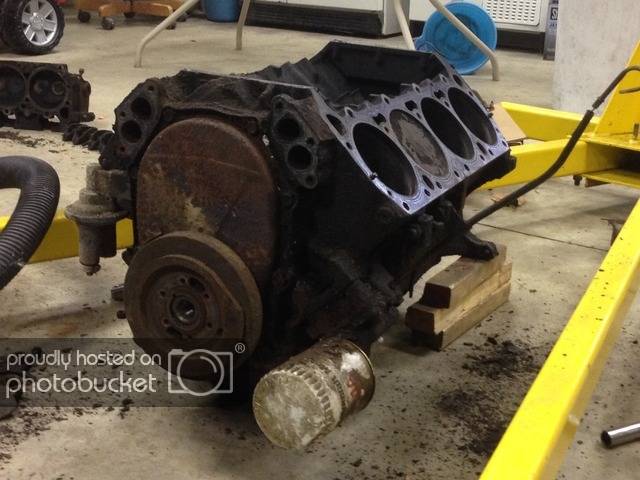

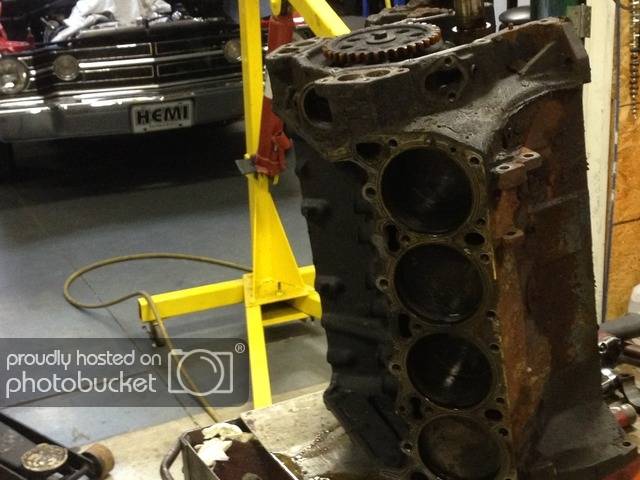

you guys got it! 72 400 "630" block. it'll be 511 @ .035 over. been sitting on the stroker kit for sometime, just waiting on the right block. 511 6bbl has a nice ring to it dont ya think
stripped and ready for burn & blast / mag check
Great minds think alike...LOL
good luck & happy strokering...
all cleaned up! gonna do some deburing, a little work on the oiling system, tap all the threads, and check the deck height before i take it for machining..

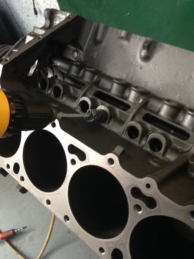

did some work today. completely de-bured the whole block. no sense getting cut every time i touch it. also this one had some nasty casting flash..
now down to business. want to keep my flat tappet lifters happy, i do this with rollers also..
debured the top, bottom, and oil hole. went over the chamfers with some emery cloth. then a few lite strokes with my ball hone. idea is not to remove material but to just clean up any burs. if your finger can snag it so can your lifter.
