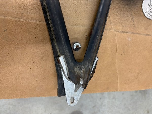

The latch part of my quarter window frame is broken off. It looks like the corner of the frame is held in by 2 rivets. This is not the latch itself it is the stem that is part of the frame the the latch mounts to. Are there any replacement option besides replacing the whole window frame? I do not have the piece that broke off
I'm pretty sure you're going to have to replace the frame. No big deal - lots available at swap meets, etc. HOWEVER, I believe Dodge and Plymouth are different so make sure you get the correct one.
I replaced mine, they are available reproduction. Are we talking about the same thing? The swing over latch? Not sure from your picture.
Want ads, or Indy swap meet. Or find one and maybe get it delivered to Indy.
