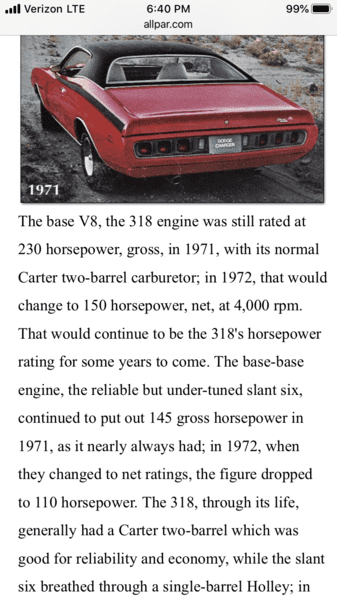

71, only the fourth year of production, is not a late model roadrunner. No 318 that year. Can't compare to a Charger, those could even have a 225 inline six.
I don’t think that site is correct? I’ve not heard of or seen a 71 roadrunner with anything smaller than a 340.
I’m referencing 73-74 cars when I say late model. To my understanding a lot of those 73-74 base models included 318’s. Both 73-74 Roadrunners and Chargers had 318’s. My belief was, beginning in 71 there were no big blocks installed. The 360 was Chrysler’s new biggest motor installed in some vehicles starting in 71 (particularly vans and trucks starting in 71-72) The 340 was the new flagship performance engine in some vehicles. The late B body model cars (73 - 74 ) received 318’s. Someone correct me if I’m wrong. I assume this is correct because I’ve seen and heard of a lot of 73-74 B body cars having 318’s ?
