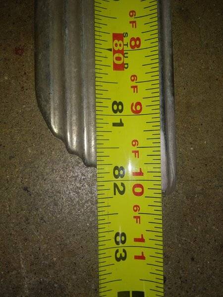

Jerry, i have a set of rocker moldings from my 68 net, if you need a measurement or pic.

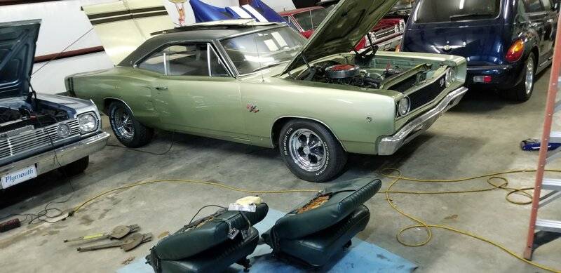

The car looks good without the moldings, but as I acquired the power window parts I needed from @3white74 I have been inspired to make the car more OE correct. There can't be many Coronet R/T 4-speed cars out there with power windows and no other power options.
The 68 to 70 Plymouth B-Body rocker trim is part number 2932 272-3. The Dodge B-Body rocker trim is part number 2932 182-3 while the 68 to 70 Charger rocker trim is 2932 180-1. The trim looks very similar off of the car, but there are minute differences. The Charger uses a unique clip while the other B-Bodies share the same clip. Remember the 69 GTX had a different wheel lip trim, so the body side trim is different. I am not familiar with the rocker trim as in post number 10 with the ribs, the rocker trim for a 68 to 70 Dodge B-body has no ribs.
